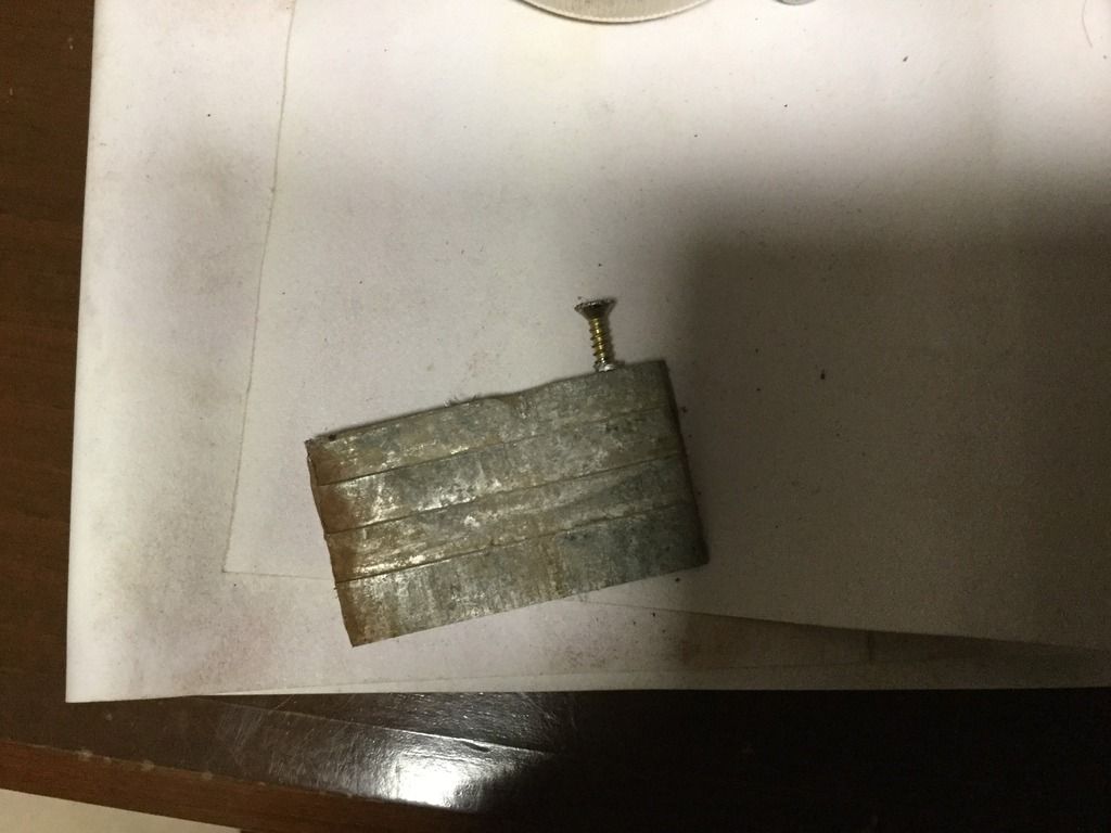

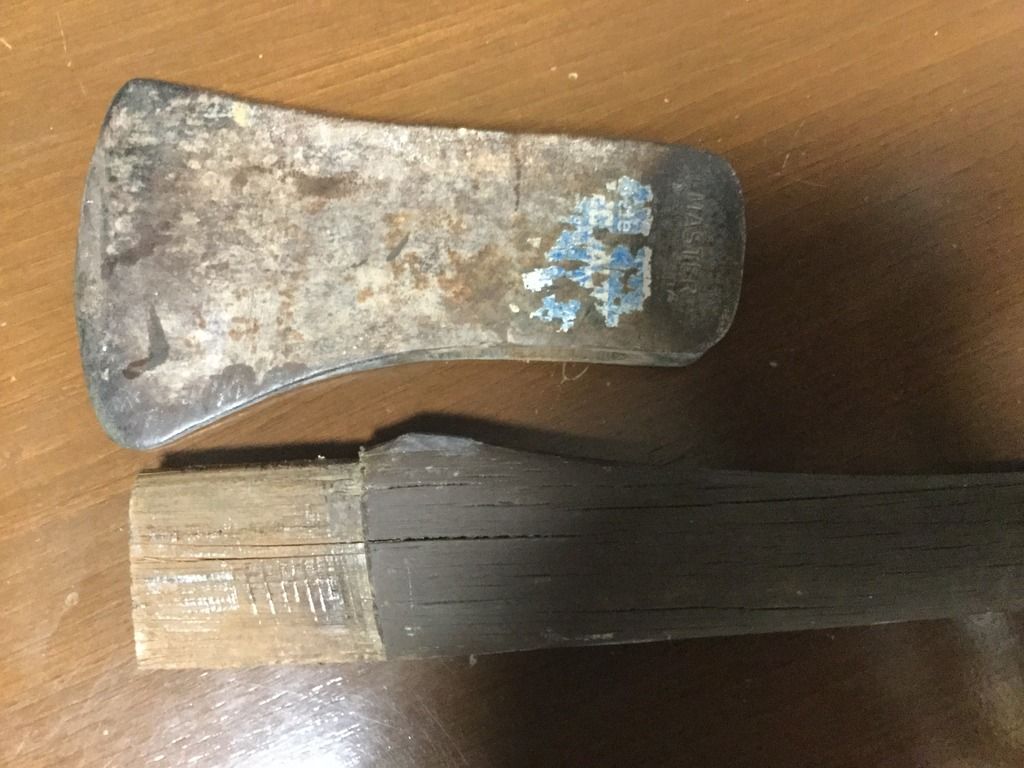

Here some pics of the master mechanics that the aluminum wedge has come off and I will try to save and restor the old handle....of course all advices are welcome, thanks again
That handle is very dry but I would try to save it too. I would sand down the ledge where the bottom of the axe head rested. I try to make a smooth tight area there. That handle will soak up several coats of boiled linseed oil. You could also remove the grime by rubbing it with 0000 steel wool.
