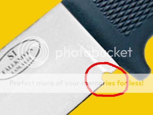

I've searched and thought for a long time but finially give in and will ask.
What's this little curved cut out area for? Why is it there and why is it curved?
Many of my knives are just straight/flat in that area, I assume for strength, but a good many of my knives have the same cut out as above.
I know the ESEE HEST has a deep notch there that is used to break wire (somehow?), but surely that's not what it's normally for?
Personally I would prefer the cutting edge to continue right up to the handle/bolster so I can slide the knive right up to the hilt and keep on slicing if needed. Thats mainly true with cardboard and such.
Thoughts?
That's a sharpening choil. The area is cut out so you can sharpen the whole edge. It's curved so it doesn't weaken the blade.
Yup...as opposed to a V-notch that would focus a stress riser in the crook of the V.
Some people do not like this feature because whatever you are cutting can slip up the blade and into the choil and bring your cut to a halt.
Ah yes well, that makes sense now that I think about it :p

What's that area actualy called by the way? Is an area of unsharpened metal between the edge and the handle or gaurd called a choil?

The unsharpened part that is the full thickness of the blade between the blade bevel and the handle is called the ricasso.

this is mostly used for ease of maintenance. without this whatever you use to sharpen you'll end up with a slight recurve with time. this cutout allows to keep the edge straigt until you reach the top of the choil.

I love them, personally. It makes it much easier to sharpen the knife using benchstones without having to worry about a) leaving portions of the blade unsharpened, and (most importantly) b) messing up your benchstones.
I've found that, when sharpening a knife that doesn't use a sharpening choil on japanese waterstones, the portion of the tang(?) that meets the edge (like on the endura below) will rub against the corner of the benchstone, rounding or chipping the stone. This happened to me whenever I tried sharpening my Leek or Tenacious on benchstones - it came down to a choice between getting the whole edge sharp or keeping my benchstones intact.
For guys who use other sharpening methods or aren't too picky about getting 100% of their edge sharp, it's probably not a desirable feature.
If you don't have the choil, the edge is lifted off the stone when you sharpen and can prevent the last 1-2 inches from being sharpened. this happenes on a lot of my Seki Spydercos because they ten to have a a very slight recurve near the ricasso which prevents the stone from contacting the edge without a small choil there..

It's not just the recurve. It's the concavity. Because that part right at the ricasso is thicker, it raises an angle when you think you're holding the blade flat. So there ends up being a point of contact right there at the ricasso and another one somewhere down the edge, and there is the section between which ends up not getting sharpened as well. Admittedly, Spyderco Sekis are the worst at this.

That style of blade (like on your fallkniven tor) is a very common blade shape for traditional styled fixed blades. The cutout has 2 practical advantages: First it serves not only as a sharpening choil, which makes it so that you can easily sharpen the whole blade, but also as a finger choil. When you want to choke up on the blade for very fine detailed cutting you put your index finger in that cutout and it will help a lot. It also gives leverage for downward cuts. The second and most important advantage of the cutout is that it alows the blade to be the full thickness of the steel stock when forging the blade. This allows it to be the maximum thickness for maximum strength. However this advantage does not cohere with lower quality knives or stock removal/laser cut blades only forged. It has also become sort of a "cool factor" also. It just makes the blade look more traditional so some manufactures put it there for looks. If you have additional questions google Randall made knives, they explain it better than I can.
