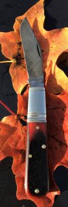

I spent years trying not to make convexed edges when I sharpen a knife. Now it is supposedly a desireable thing? I’m not buying it. These are examples of my free hand sharpening IMG_3302.jpeg
