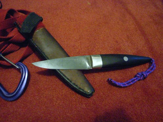

I'm using M2 blade built by myself for fourteen years.
It's hardened to Rc 65 and yet quite strong, can carve most of the production knives ;)
Not so difficult to sharpen compared to other kind of stainless,
quite similar feeling of sharpening stainless and quite different from plain carbon steel
My blade is covered with patina as it sometimes easily suffers rust like carbon steel.
Maybe the best sharpness will be inferior to plain clean carbon steel.
But shows better edge holding especially dealing with hard-to-cutting materials.

your post is useless without pictures. :)
Hi, thanks, morrowj_98.
here it is.
handle scale is red sandalwood, and he sheath has ABS plastic plate inner frame.
here it is.
wow...that looks quite good...a solid looking worker. you should make more of those. :)
that's an interesting looking sheath as well. do you wear it around your waist or around your shoulder with the knife hanging under your arm?
Thank you very much for your attention, morrowj_98.
I'm a climber. Red tape webbing is for wearing the sheath around waist or from shoulder
when I am at the camp site. The sheath has two loops, one for belt and other for
a carabiner, which can be used to hang knife from climbing harness.
