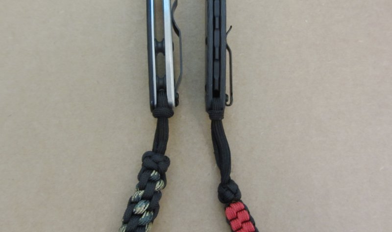

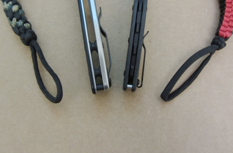

The 0562 doesn't have a lanyard hole, but the 0620 (and 0630) and 0770CF can accommodate one. They have a lanyard pin at the tail end of the handle. You can loop full 550 cord through the 0620, and the 0770CF will fit gutted 550 cord. If just tie it on directly on the lanyard pin, you can also fit full 550 cord on the 0770CF.
Camouflaged blades and no lanyards make the ZT knives more able to get away from you and not be found. That's why they are great for Survival, Evasion, Resistance and Escape.
The 0620 has a dedicated lanyard pin in the butt end of the knife (so does the Sebenza 21), and the 0562 uses the rear stand off (so does the Sebenza 25). So there should be no deal breakers with any of these knives.
Not having a dedicated lanyard hole through both handles generally allows you to have a better blade to handle ratio. It also tends to look cleaner and likely saves a fair number of additional finishing steps.

The 0770 and 0620 (and presumably 0630) all have what appears to be a lanyard pin at the tail end of the handle (see pics above). Does it make much of a difference if the lanyard goes through a hole in the sides of the handles as opposed to being tied/looped through a lanyard pin on the tail of the handle?
Not sure about the blade:handle ratio but I do notice a cleaner look to the newer folders without a lanyard hole. It seems to give a knife a more streamlined look. I still prefer a hole over a standoff though. Some of the knives don't allow much blade clearance to use a standoff.
