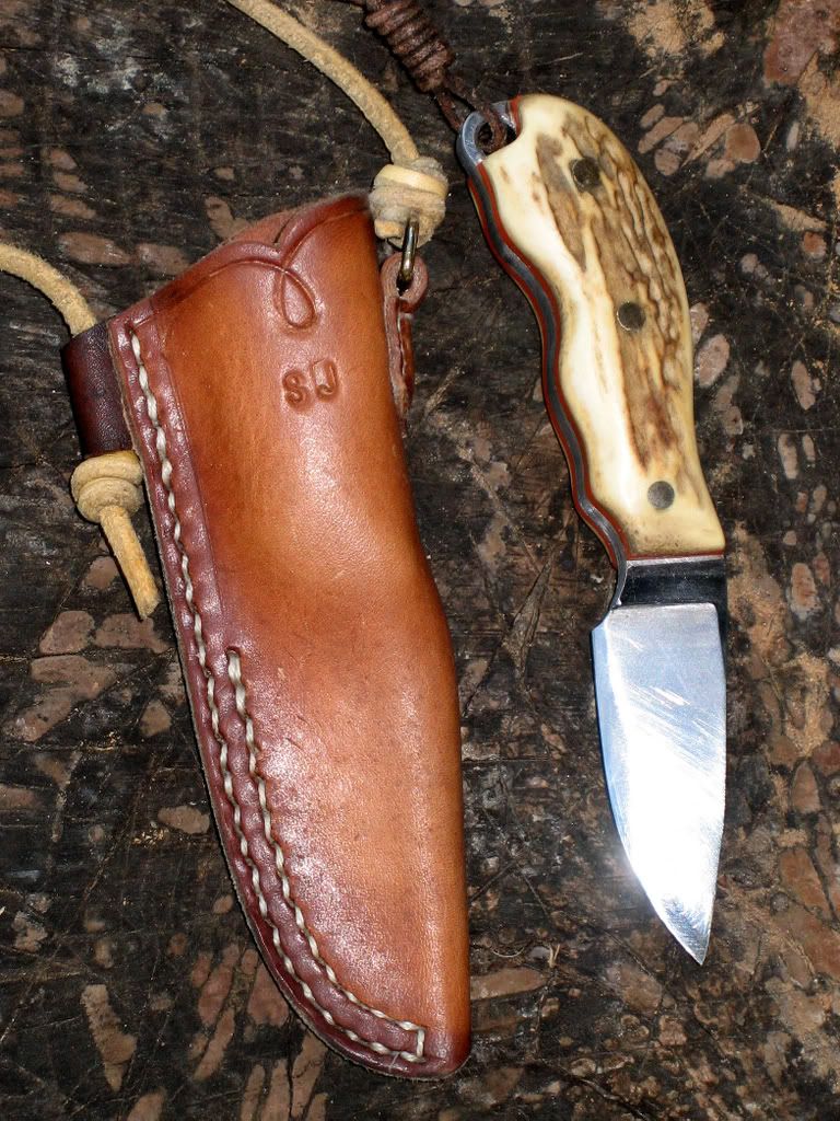

I have contoured it. The pith can be an issue.
[/url]100_2283 by Wjkrywko, on Flickr[/IMG]
This one is from a while back. I have been much more meticulous in my finishing as I have gained more experience.

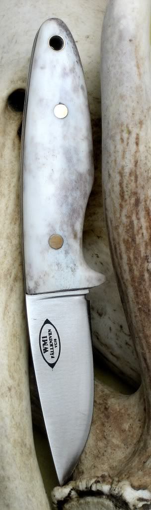

That is a contoured stag handle for Fallkniven WM1 I made.

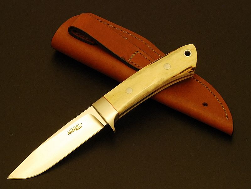

If you look at knives from the 80's there were more contoured stag handles and stag that was ground down almost smooth, making it look 'sort of' ivory like.
An 80s-esque Herron inspired Denning.

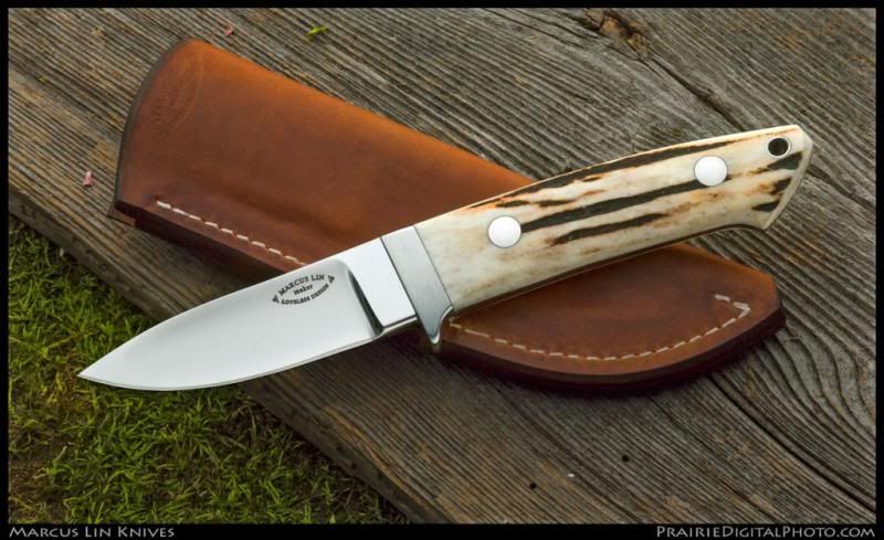

Here's a Semi-Skinner that I made a while back which had a contoured handle with some verified Indian sambar of yesteryear:
The stag is very white in color (more white than the photo), almost like Ivory, with character. Cutting and machining were also more difficult as the material is much denser. I don't recommend this, but you could probably drop and not damage it.
