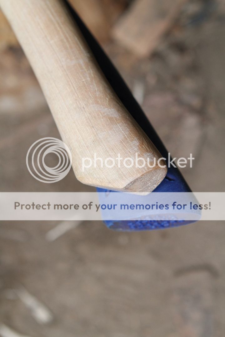

I wanted to get a Hudson Bay style axe for a while and recently I did, a Council Tool. The head came loose after 2 days of a 5 day camp trip where I was sleeping out next to the fire. Once it came loose in camp I didn’t feel very good about using it. I sent it back and they replaced it (yesterday). I chopped into an old chunk of seasoned wood and while the bit was buried deep inside the wood I noticed some handle play again. The new one was loose. When I got it the aluminum wedge was a little bit sticking out and the head itself looked like it could have been seated a little more down. It actually stuck out more than the top of the handle.

Loose head:
I have started to thin down the shoulder with a file, but I won’t be able to finish it or do anymore work with it until I return from a trip.
