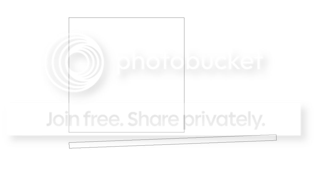

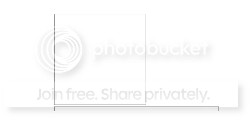

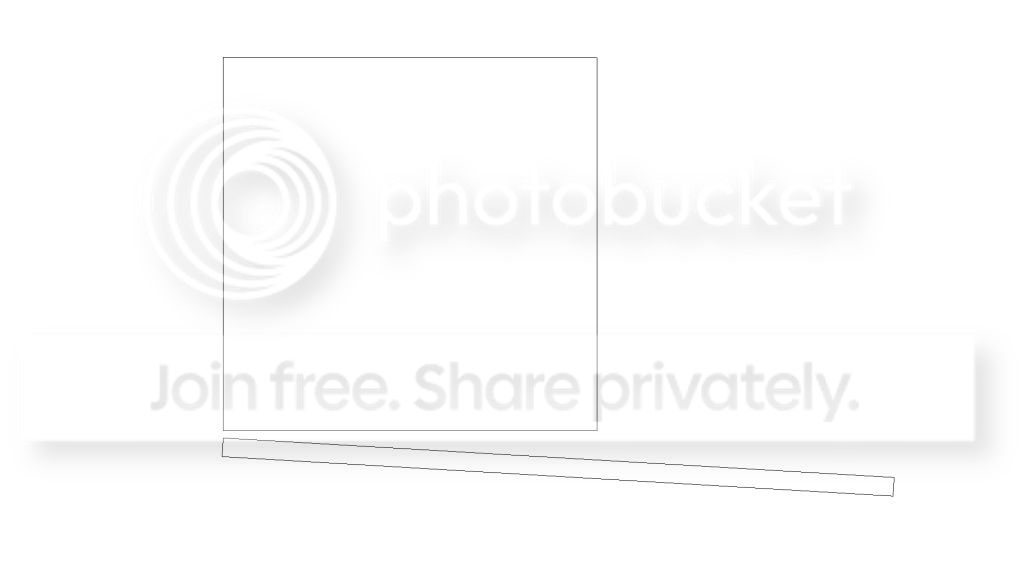

I am going to make a guess here with you are coming into the belt at an angle, flattening out through the middle and pulling the handle out to far at the end
handle is to the right if the screen
you come in like this
start coming across and flatten
and pick up to much at the end
just my guess, that is what I was doing:o
Nathan beat me to it, and yes I now get the 2" line
Something that many makers do is to actually touch the bevel gently to the belt away from the plunge, giving yourself a chance to get the bevel flat on the belt, the push into the plunge (keeping things flat), and then draw the bevel across the belt towards the tip staying flat at first and then rocking the handle out as you approach the tip as illustrated above in order to get the line to curve up towards the spine.
If you rock out too far, you'll have too much curve in your grind line towards the tip as Unky suggested. Not far enough, and you grind line will be more flat. Start rocking out too soon, and your grind line will start to curve up too early. Too late...well you get the idea ;).
--nathan
