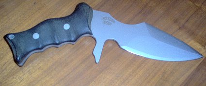

Many fighting knives and bowies have the blade canted at least some, if not a full 45°. That changes the grip drastically. Szabo UUK as an extreme for instance.
Many others have less drastic cants.
That's almost the idea but not down like that one pictured but to the side when looking over the spine of the knife.

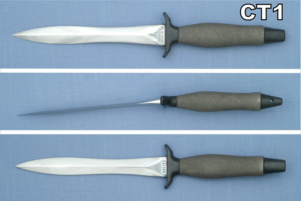

There was a variant of the Gerber made Fairbairn Sykes (sp?) fighting knife (Mark II) that had the kind of cant you describe. They are quite valuable as collectibles.
Yeah, that's more like I had in mind. Thanks for finding that picture! I was thinking that the cant would be more extreme than that one though. I understand that it probably wouldn't allow for many different grip styles like the standard shaped knife. Thanks again.

I have heard two reasons for the cant on the mark II. I am not sure if ether was true?
1) so you didn't break the blade when you pushed thru a mans ribs from behind into his heart.
2) that it would contour to the side of your leg better in the sheath when you landed from parachuting.
I have handled one of those Mark II's and I was always curious what the true reason for it was?
I didn't serve in the Military and the little training I have taken was empty hand. I make mostly culinary knives and a few hunters.
Do you have any idea if there is any truth to those two reasons for the cant on the Gerber? Or is it the index finger or thumb indexing?
Laurence
The simple truth is that the cant was a design feature that accomplished two things: First it allowed the knife, when sheathed, to be kept closer to the body. The bend allowed a better match to the curved contour of the hip, calf, thigh or inverted carry taped to chest web gear and thus would help to reduce snagging. Second the angle was designed to keep the blade horizontal to compensate for the natural bend of the wrist when the knife is held with the "Fencing foil grip".
