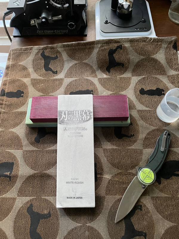

Here's my test set up. LOL
So far so good. My edge appears much less convex than I normally get, and even on this 120 grit profiling stone the knife will slice paper. Normally I couldn't achieve that without going up at least one more grit level. I've got a magnet glued to the bottom of the bullseye level. Why a level? Am I that spastic that I can't even hold the knife level? Yeah.

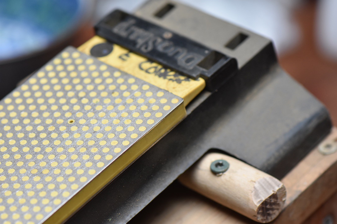

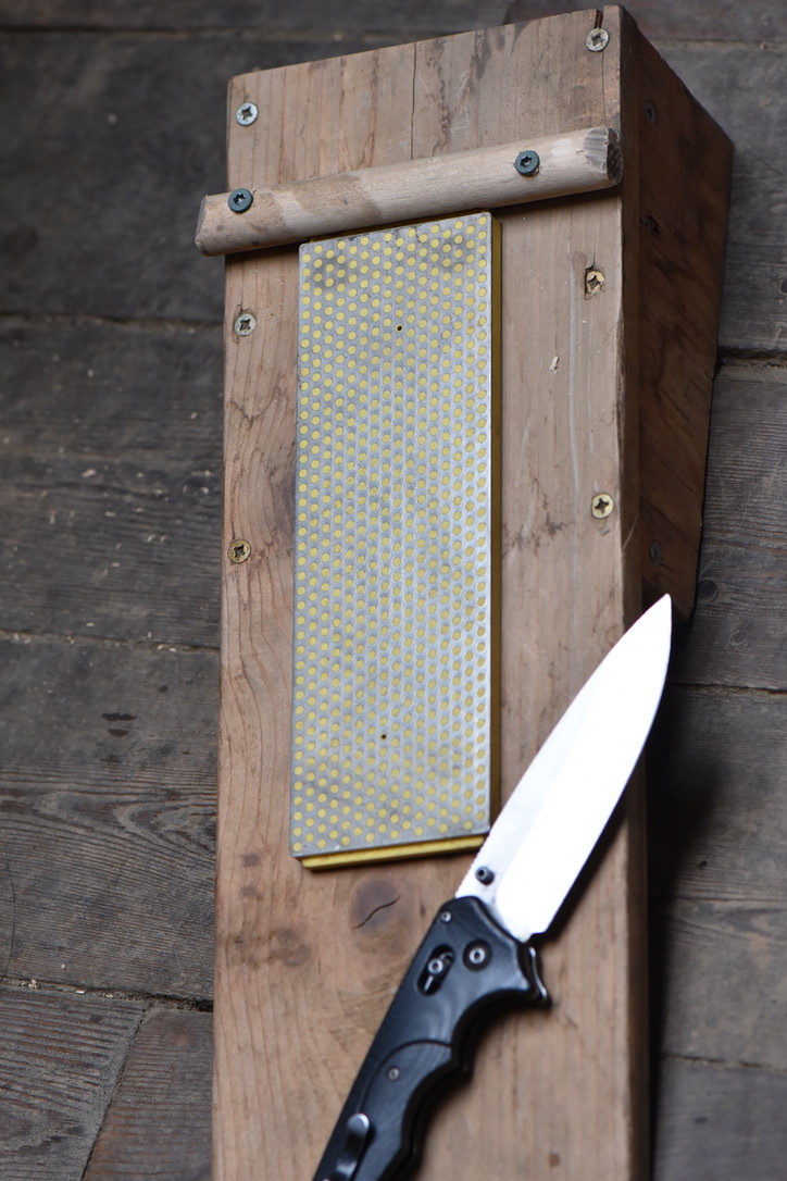

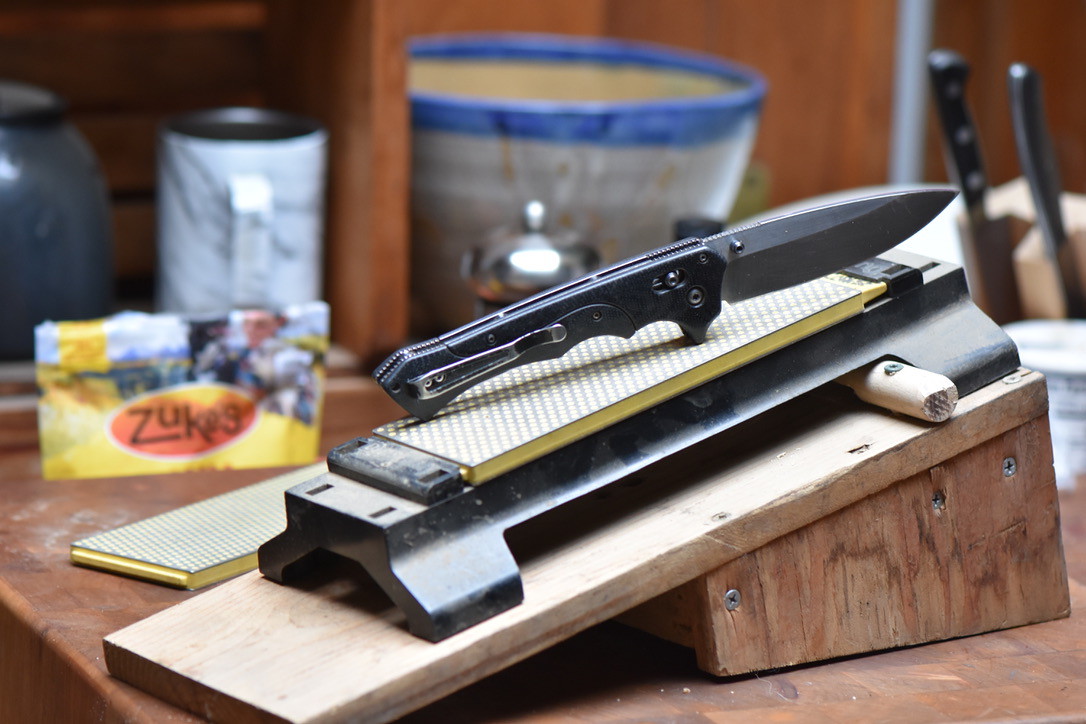

For serious sharpening, I use my Wicked Edge. But most of the time, I can just tune up my edge quickly with diamond stones on a 30 degree ramp. Most of my blades are 15 dps. I use the Sharpmaker for a 20 dps microlevel. I just hold the blade horizontal, rather than vertical like the Sharpmaker. Not fancy, but fast and effective.
It is this quick and easy. I can use the full DMT holder and it holds nicely on the ramp.

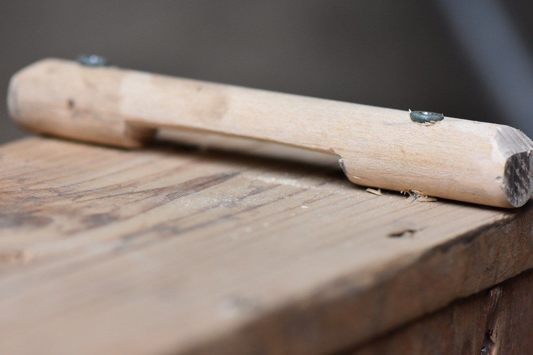

It just sits over a dowel.
Or, I can use the DMT stone alone. It will slip under the dowel and be held in place.
