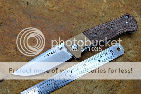

Bit of both G10 and Micarta. G10 bolsters and Micarta scales, liner lock. Used like that both materials are adequate for the job, if the Micarta discolours a bit then it shows the knife isva user like any tool should be.
Y-Start.
