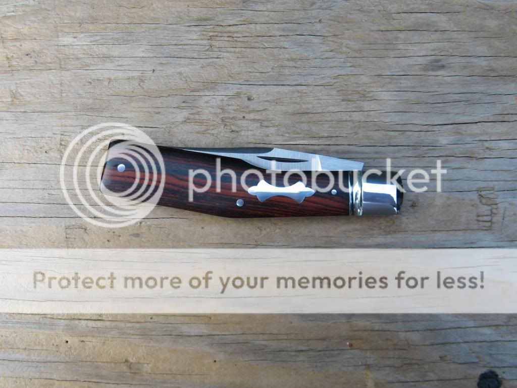

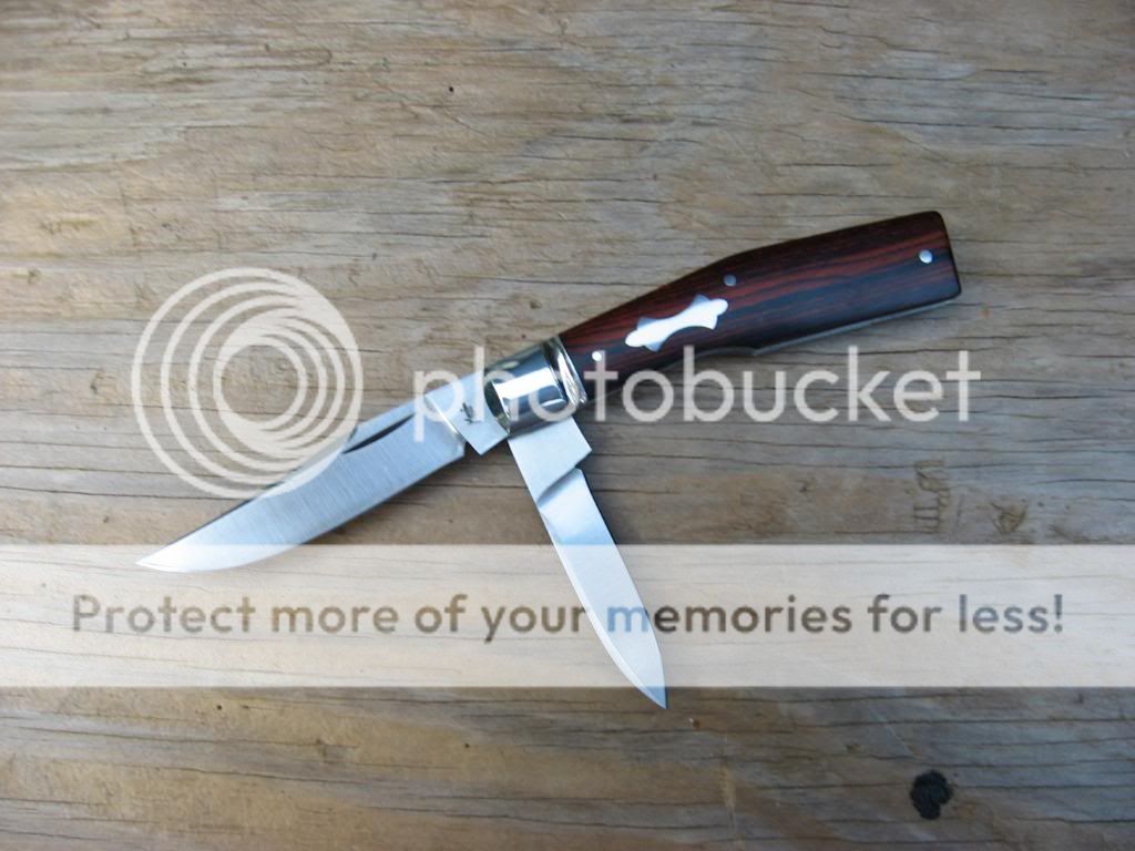

Chris, Here's one with some wood! Cocobolo
It's some nice stuff...imho
