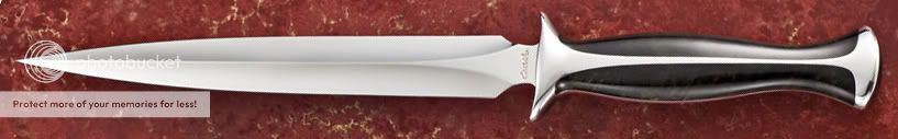

I'm using hidden pins on these because I like the clean appearance.
carothers_dagger.jpg~original
I cut threads on the inside of the hole in the scales and I use the next size down all-thread for pin stock and I use Acraglas on everything when I put it all together, so it forms internal threads. And since you can use lots of small pins I think it prevents an end from lifting over time better than just two or three pins.
