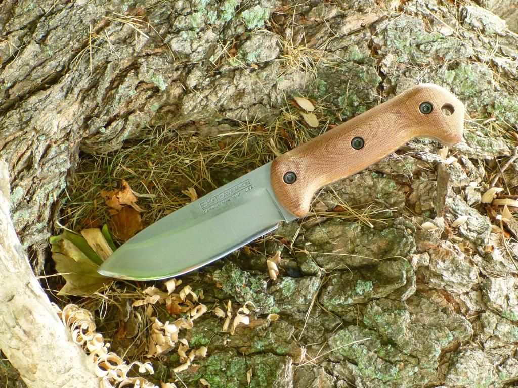

I go back and forth on it. Have both and like both. A well done convex is a pleasure to use for woodcraft and easy to keep sharp in the field. Just strop it on your pants. Depends on your equipment too. If you have access to a belt grinder you can convex it in five minutes. A sharp V grind seems to do better for me at slicing and food prep. This old Cam BK2 has been convexed for twenty years or so, and remains one of my all time favorite knives. Just a matter of taste and blade geometry. Some knives benefit from it and some do better with the V grind. Thin knives or full flat grinds are lasers with a V grind. I personally like thicker knives convexed. I also like the edge Jerry Fisk puts on knives like the BK5. It's convex but gets a few licks on an India stone to finish it up. Just a personal preference.

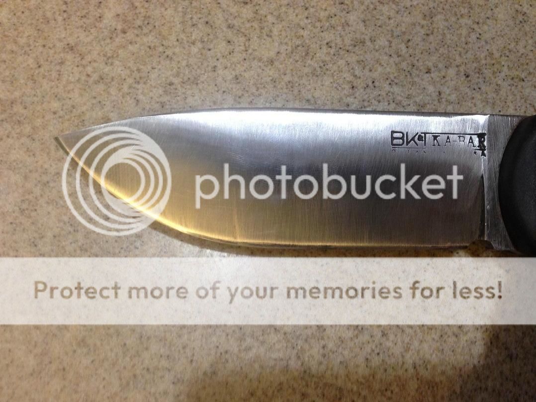

Because I'm freehand sharpening, my secondary bevel isn't always perfectly flat, but I do attempt a flat grind. When I convex ground my BK2, it did it on the primary bevel, taking it from saber-ground to something with less of a step. My unscientific testing showed the blade going through wood even better once that was done.
For something as thick as the BK2, I don't think a convexed secondary bevel helps at all. Maybe it would for something really thin.
