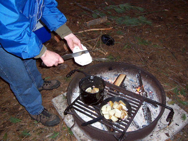

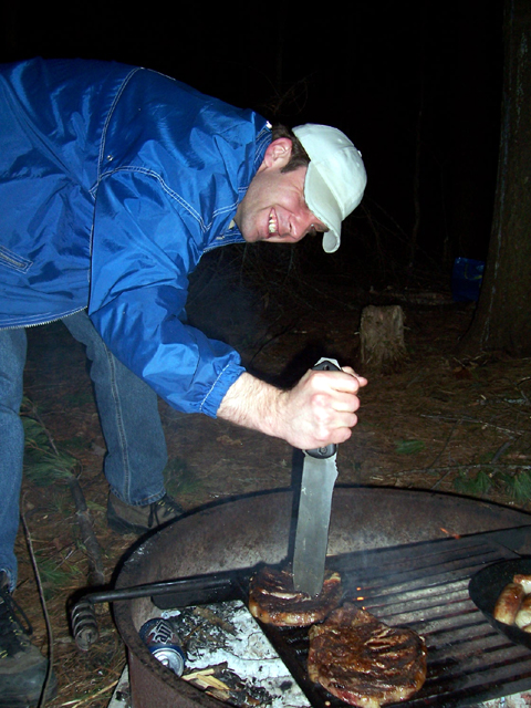

Because sometimes you just really need to hack things. I live in a rural area with lots of dense scrub, second grow, and swamp, and a big knife is invaluable just for getting around in the bush. A big knife is handy for making kindling. And they're useful for grilling steaks and other cooking purposes, as evidenced by these pics of my brother doing some cooking over a campfire this spring:
0009d23r
0009k874
Admittedly, a BK-9 is massive overkill as a butter knife, but it sure did get the job done.
