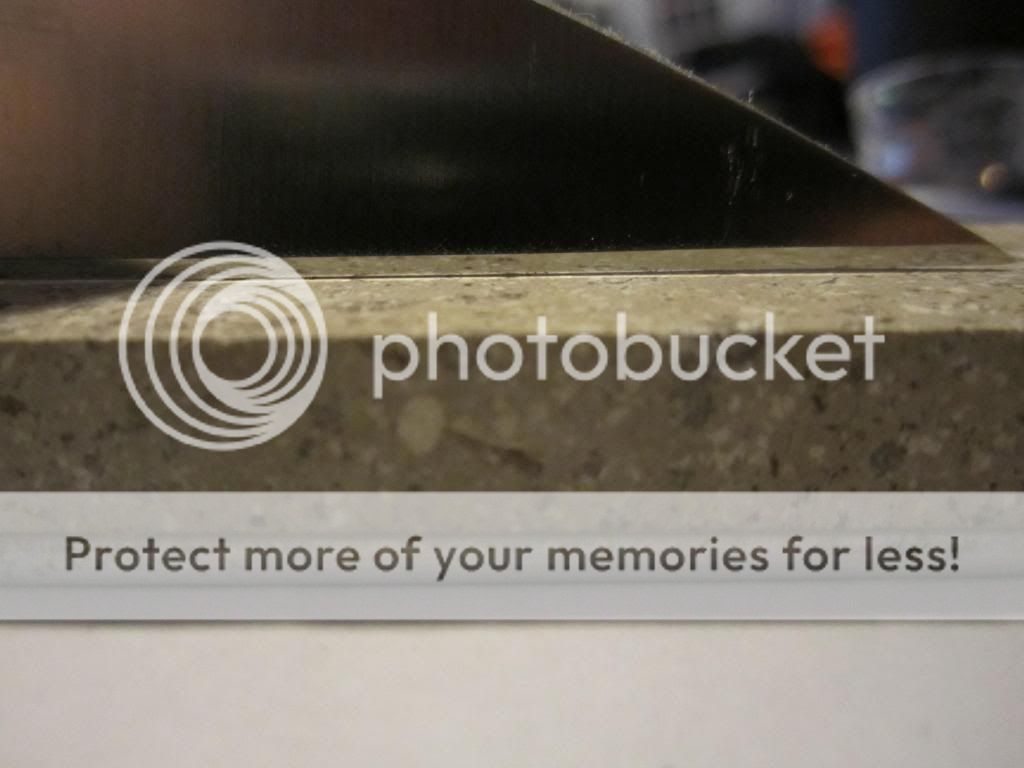

Jnat Kouzuke posing for the reflection shot , this is straight off the stone , no stropping

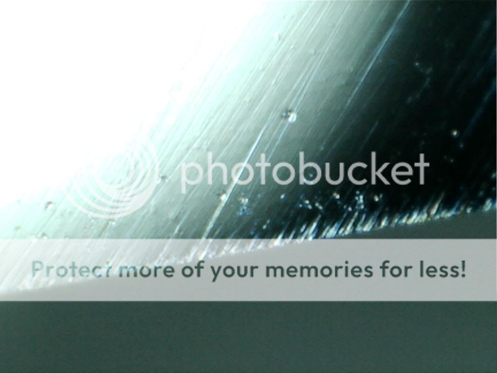

Micrograph
Missing a spot there in that micrograph.
Did you miss the "edge of the edge?! ". Lol. The rest of the bevel looks awesome though.
Couldnt figure it out so i spoke to the master of the Shaptons , Thomas Blodgett about it. He said that it looks like 30k scratches , but the edge of the edge was getting so thin that it was starting to flex a little bit. The knifes performing like it should.
Interesting theory, sounds plausible. At what magnification level was the photo taken?
Is there any way to calibrate to a scale?
I have to believe the explanation, but less pressure should get it clean right to the edge - the abrasive should keep working at a lower amount of pressure than what's needed to flex the apex.
I'm not sure what you are asking with the calibrate question. I agree with you to a point that reduced pressure ought to help, but we don't know the included angle nor the magnification. If the magnification level is very high and the included angle very narrow I could certainly see flex happening. Down in the fractional micron thickness range (which a good edge should be) even hardened steel is flimsy. So a small amount of loading or a little too much pressure and there you go.
I was thinking there should be a way to put a scale on these pics to see where its at. Magnification would tell a little, but not the same as having a scale - was more a question to Sadden, not to you.
Yes, too much pressure would flex the apex out of whack and not get it treated well. Should be user-correctable.
Magnification is 400x through a veho.
Steel is Aus8 , 20dps , hollow ground
Toms advice was to go back to the 8k and do alternating strokes even lighter than i already am. Doesnt take long , just didnt get a chance to last night.
It sounds to me like he has got you sorted. At 400x that is not a very wide area at all.
