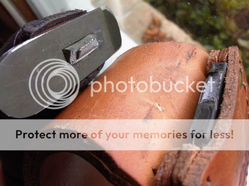

i have an ontario knife that drove me nuts trying to get an edge on it. a buddy came over and i gave him a crash course on sharpening on my equipment and he tried to sharpen it. he had the same luck i did. i ran a file along the plunge line and it cut into the blade so i knew it was a bad heat treat. maybe that is the problem with your sak.
I had an ontario knife that I could not get sharp period. Let me see if I can find it and take a quick cell shot of what I was able to easily do to the knife with my bare hands.
Here you go, two cell pics:
