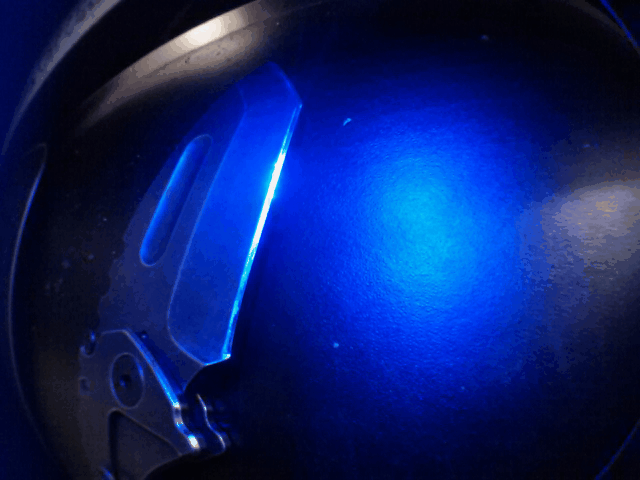

After getting a pretty good look at one at the East Coast Custom Show last weekend - I took the plunge. Amazing. Just did over the ZT 550 i picked up - 100-1000 grit diamonds using a sharpie to see the progress @ 25 degrees and then 100 strokes with the two strops and paste. MIRROR POLISHED EDGE. I have been trying to get that for months. MIRROR. I can almost see myself in the smoothness. Anyhow, the Lansky and the Sharpmaker were good practice, but this thing is Carnegie Hall.... (Keeping the Sharpmaker in the kitchen tho - damn handy for the day to day knives) and even my wife enjoys it!).

A few years ago, I pretty much exclusively used Spyderco ceramics (including the ultrafine rods) and the best I could do was this:
Here are a couple of pics my friend took while we were on vacation in the Outer Banks. I don't know much about photography, so all the credit goes to her.
I'm also impressed by how well the mirror edges showed up in the pics--it took a while to get those on there!:thumbup:
Hopefully I link these correctly (it's my first time posting pics).
Enjoy!
While these appear to be like a mirror, they aren't true mirrors in every direction. I've had better success nowadays using waterstones and strop compound (up to 0.5 micron diamond spray).
All of the edges shown, by the way, were done free hand.
