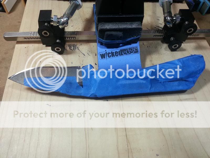

When I sharpen a folder I either tape off the whole knife from the ricasso back or else put it in a small ziplock bag and poke the edge out one end and wrap the bag around the handle and tape it up so it's dust proof. Uses less tape that way.
Even with the "play" in the old arms the results were still amazing! I have since upgraded to the new arms but that was just me wanting a new toy. I hesitationed to use it on my CRKs at first, but got over it and use it now without a second thought. I also have a worksharp KO, and use it in a similar way that Officer does above. When using both of those systems, I tape the knife up to avoid dust getting it the pivot area. I didn't do that a couple of times (luckily not with a CRK!) and the resulting gritty action drove me crazy and I am sure caused unneeded wear.
