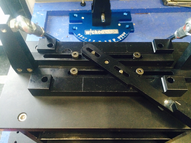

I'm curious about the mechanism that sets the guide rod angles; are the ball joints on the same line with each other like the prior WE's, or are they slightly offset from each other due to the single lever adjusting system?

I don't have one, so take it FWIW, but it's my understanding that the clamp on the Gen. 3 is self centering, so there's no need for one side to be slightly offset. The arms do have the micro-adjust feature on them also.
The single lever I was referring to is for the guide angles, not the one for the cam vise lobe. Basically I mean are the ball joints lined up on the same bar?

As far as I know, the part(s) the ball joints are connected to above the blue plate are lined up... not sure how it works underneath the blue plate though...
(Threw in a picture for reference).
It works as you would expect.
I took mine apart to clean it.
It has a few minor things you may want to "hot rod".
It is well made and I'm happy with it.
Thank you Bazzle, as they say a picture = 1000 words. That answers my question perfectly. I thought the two arms would have to be on different sliders, and your picture both confirms my guess as well as explains how WE designed the alignment - by putting the risers both on the "inside" so they are lined up straight with each other. It does indeed look like a fine setup. I'm not sure whether I'll go with Gen 3 or a Field & Sport Pro (which also has the cam-vice and ball joints, but clamps to table and has manually set guide arms).

Yup, good picture, thanks.
