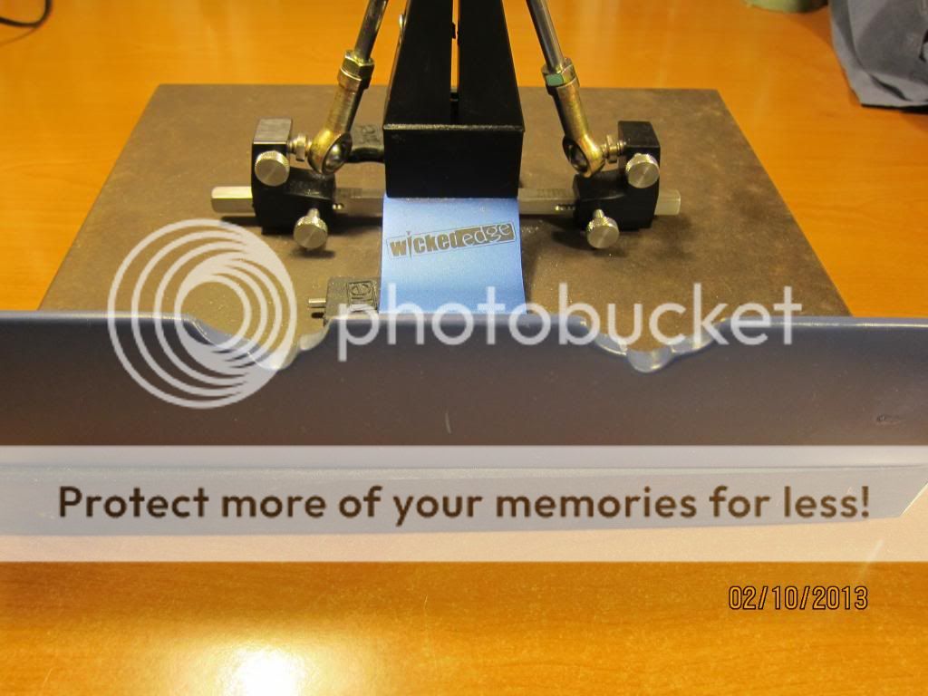

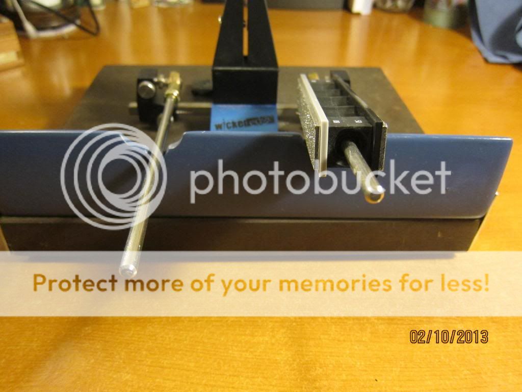

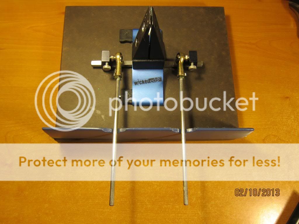

Hey members,
Here is a mod I did of my wicked edge that saves me a little time. It makes it easier to put stones down for edge checks, change stones, and just makes sharpening easier and less of a hassle. Check it out!
Not perfect but it was "tangent projec"t that a did in a few hours with limited tools (not at my place) and didn't care if it was dead even. Although now that I notice it I may have to make a version 2.0. haha
This helps with change between stones. I don't even have to touch the rods!
There is also decrease grit contamination bc I know the stones are always touch a clean surface. They stones actually hardly touch anything if they do at all!
Note the dedicated resting spots for just the rod and the rod with stones.
Anyway just thought I would throw it out there to inpsire people to post their Mods that help them save time or just makes the WE better
Im just sayin..
Cool! What did you use to make the stone-rest from? It looks sorta like a section of a wooden window blind slat...
TedP
TedP
Hahah close! it is some molding or base board I can't remember which for sure. It was on the left over pile and was just the right size and it's easy to work with and unfinished so it's what I used.

Nice mod - Great to see what mods people make to make the system work better for them :thumbup:. I've seen a number of rests for the guide arms but never one so tall or with the rest notched for the rods and rods with stones. And nice color too.
Wondering why you did it with the rest on the front instead of the back - or perhaps you use the sharpener reversed so you can do the screws with your right hand? I lay down my guide rods going away from me and when I put on new handles I hook the rods with the handles where they hang off the front of the base. For me I think this would interfere with getting to the set screws on the collars as I grab them straight on to tighten them
I also noticed in your pics that you have the shorter (original Gen II) base rod mounted on the sharpener - do you prefer it over the longer one that comes with the ball joint arms?

Its mounted on the front relative to the way I use it haha. Its mainly bc I have always used it that way and was the way I decided to put them on. Most likely because its easier to tighten the screws you are right. Its funny how our mind automatically think like that without any real thought. My dad always said work smarter not harder! haha I have had a few people ask me that actually. Good observation! As far as the bar I was one of if not the first to order the production model of the new arms and the bar actually did not fit in the new arms so I had to send it back and that was the new on they gave me. I know they changed the bar a little but this was after they had sent me a new one.
