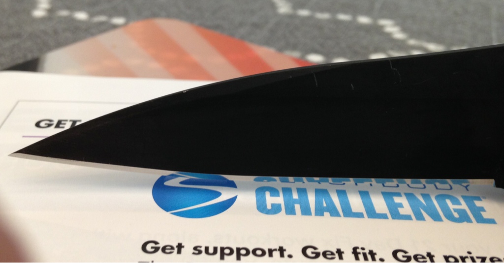

I achieved this semi mirror with the basic diamond KME and a few strops with diamond past..

What a fantastic edge!
Can you tell us which knife it is?

Thanks for the kind words. It is a co-workers kershaw leek. The tip turned out really well. Hair whittling edge that was S cutting phone book paper with ease. I'm still learning but after about 30 knives I am starting to get the hang of this system.
I still have issues with getting the tips sharpened without making making the bevel larger. It's definitely my fault though, not the system's

The key is to balance the knife's clamped position. If I can't clamp in the center of the blade, then I angle it somewhat. I then put in the rod with any stone, pick a point on the rod or stone, plant a finger on the rod for placement (to keep it from extending or retracting), and see where it falls from one end of the blade to the other. I usually use the end of stone, or the knob as the point to compare position at blade edge. Using this method, a blade with a lot of belly or curve, may have a bit of bevel difference (thus sharpening angle difference) in the center, but exactly the same at the base and tip.
Take a longer blade such as a kitchen knife. Most people will clamp it closer to the base because it's flatter and a little beefier. And somewhat perpendicular to the rod at the center point (clamp area). As you move the rod/stone from the center out towards the tip, the rod flattens out making a shallower angle the further you go. This will sometimes give you that big honking bevel right at the tip. But using my method above, you can angle the blade in the clamp, and find the point that yields the same angle from one point of the edge to the other. You can even put the KME on the base, and on a level surface. Then put a digital angle block on the rod (I just use one of many free iPhone level apps) to compare the angle difference as you progress from one end of the blade to the other. For some of my expensive blades, I take the time for this step so I can achieve a near perfect bevel and at very specific angles.
Sorry if I'm not making sense. I'm not an engineer, just a guy that likes a sharp edge with perfectly balanced bevels. ;)
