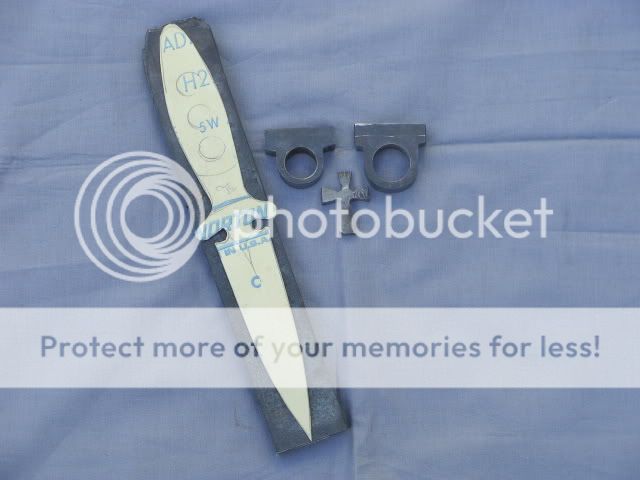

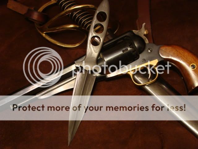

the wife has been hounding me about a boot dagger for her civil war boots and something she can put in the truck on the door for the bad guys so i made this for her ,this dagger is hollow ground with a 1 1/4" wheel the billet started out 1/2" thick 30 layers of 52100,15n20,some L-6,and 1095 ,i also made matching rings for her and me from the same billet its raining today so i'll be working on them today pix's by the end of the week but i'll show you what i started with.this dagger overall is 9" long the blade is 4 1/2" long
Now i can get my Coye ridgeback back from the wife she said that was hers until i made her something .LOL
looks awesome!

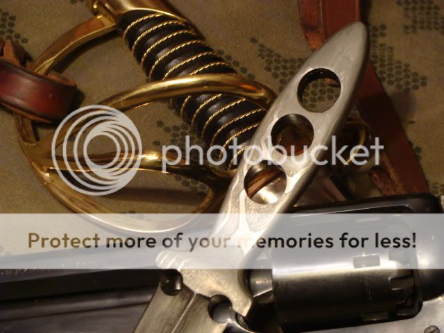

if I had to nitpick, it'd be that big holes on handles sometimes mess up your grip when your fingers fall in.
