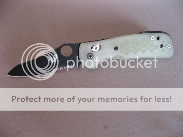

Question re these grips and the pocket clip attachment...
The large Griptilian has metal inserts in the factory scales for the clip screws. Does the Wilkins grip have the same? I really hope the screws don't simply thread into the G10...
Is the mini-grip the same situation? I don't know how the clip attaches to the std scales on the mini, same way I assume?
The pocket clip screws screw into the metal spacer.
That was my thought as well, but looking at pictures, if the back spacer was that large, I don't think the blade would clear it when folded.

I looked at mine. One came pre-assembled on a knife, so I took one of the clip screws out (much longer than stock), and the other, a mini, I put on a Ritter version of the Mini-Grip myself.
Just got my mini Wilkins the other day. The clip screws screw into the metal liners which on the mini extend almost to the end of the scales, not the back spacer.

My bust - I was in a rush - the mini version's clip screws screw into the stock Benchmade partial liner holes.
EDIT: Got so irked at getting my answer wrong I went and put a spare set of Wilkins scales on a spare mini-Ritter Grip. 15 minutes.

So in Summary:
Full Size = clips screws into backspacer.
Mini = Clip screws into the knife liner(s).
