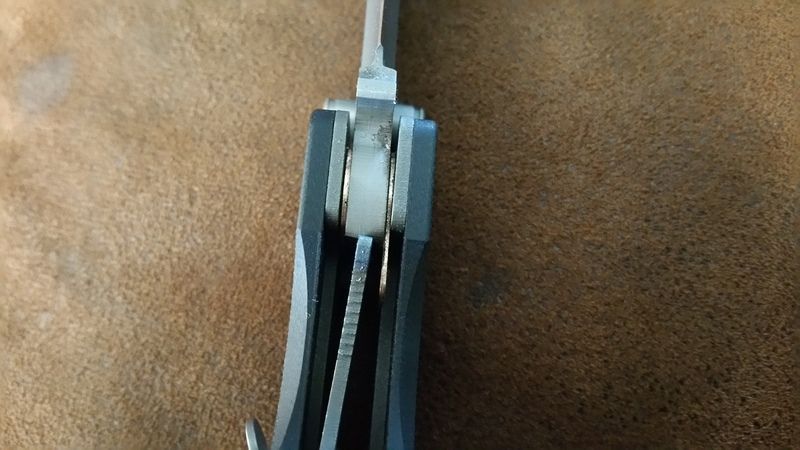

I have an 881 small spear point that I think will eventually need lock work. The liner lock engages about 3/4 of the way across, but I have a feeling it'll make its way all the way across.
Here's a pic:
Can (or will) they fix it so the lock engages earlier?
Gee, I don't see the problem here, the engagement looks safe and secure. It's not really a wear point in a quality knife. It's the knives that barely engage that worry me. I just looked at two Strider 880's in my collection and they both engage about the same amount with a nice reassuring "click". I would worry about accidentally disengaging the liner lock with a shift in my grip if it was closer to the edge. I see you are a knife maker so educate me as to what I am missing about your concern. Somantics.... it's not about how "SOON" the liner lock engages but how "FAR and SECURELY" the lock engages. Even if the liner lock did "WEAR" to the point of moving all the way to the right in your picture, the lock would only be engaged more securely. Put another way, in my opinion, wear would only make the lock safer.

The pic doesn't show it very well, but the bottom part of the blade that contacts the lock bar is cut at a very shallow angle. When the metal wears, and the lock bar continues to travel across, it will reach a point where the blade will be loose because the lock bar will be too short to properly engage the bottom of the blade.
I love this model--I've owned every version made in both sizes over the years--but the issue with this particular knife is real.

I didn't know if Buck would service the knife due to it being a discontinued model, and because I doubt they would have spare parts on hand if it became necessary to replace something.
I had some work done on mine. Looked like the had 3 or 4 extra lock sides.
Try loosening the pin the blades rests against when closed. Hold blade closed tightly then retighten. Worked on one of mine.
