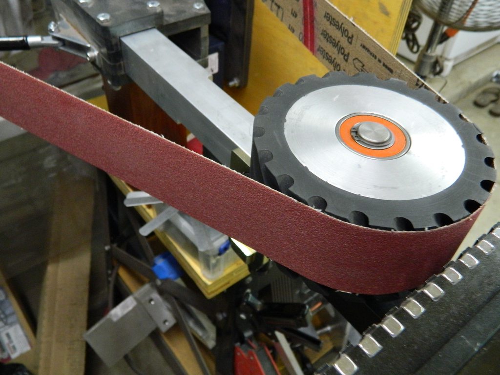

Bert and Walt, the Wuertz surface grinder will work with both of your grinders that use 1 1/2 square toolbars in the verticle configuration. I used one on my KMG but I wanted it to work horizontal like on the TW-90 so I took the tool arm bracket off the toolarm and made my own aluminum tool arm with 1/4 inch milled off the bottom and 1/4 inch milled off the right side so it would be like the TW-90 1 /14 toolarm. I mounted this on my Polar Bear Forge grinder tilted horizontal and it works perfectly. You could tilt your grinders and use the same toolarm. Here is a photo of mine and you can see the milling cuts are only on the last eight inches of the toolarm so the rest fits a standard 1/1/2 inch tool slot. Larry

Thank you so much for the advice on that. This is great to know, really appreciate the picture too. I really like the pheer 454 and had talked briefly with Jose a month or two ago and he seems like a great guy.
