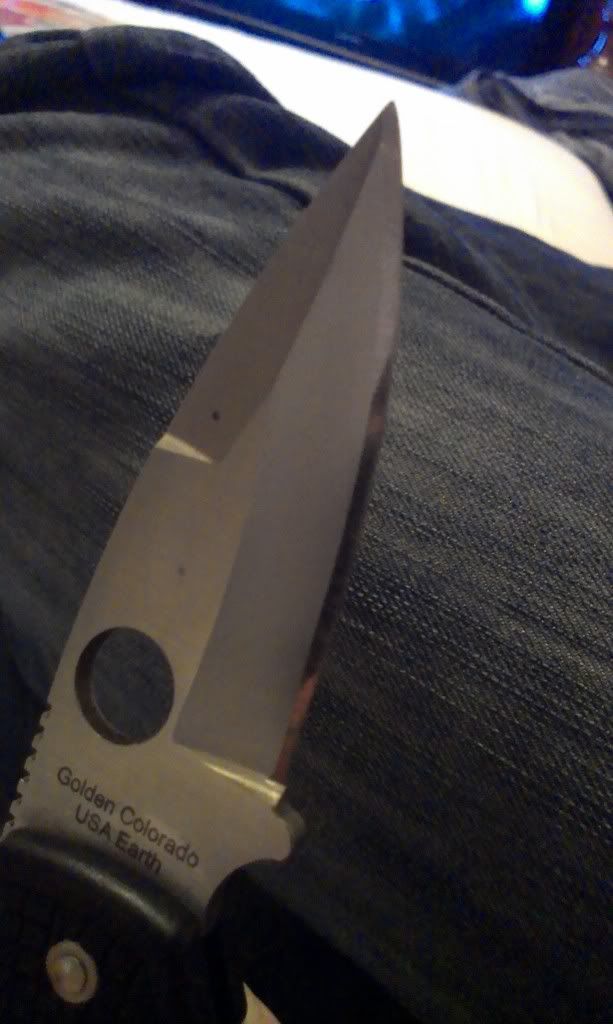

I found a small piece of flat scrap furniture wood (I think it's actually burl that I had for scales!) and am making a mini strop to see how it fairs. I used a thin layer of elmers wood glue and it's drying now under the compression of a heavy box.
My knife, as you may have seen in my "loaded stones" thread is an s30v Spyderco native. I finally got a good 17° angle on each side. It's not a mirror polish right now, but there is definitely a good polished edge with only some scratching keeping it from mirror status. Hopefully I can get it closer to a mirrored edge with the green compound.
Otoh the compound is from harbor freight, so who knows how consistent this stuff is.

Thanks for the advice guys!
Okay well the edge is not mirror perfect. I suspect that some of the deeper scratches won't come out with stroping alone.
I can say this however... the strop (and leather) works very well. I'm not sure if it was technique or a result of the belt leather I had used in the past, but this is the sharpest I've ever gotten a blade no question. I'm purposely leaving the very edge just a hair off the leather and using pressure to get contact. Seems to be a viable technique. :)
