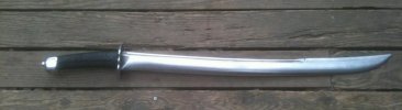

willow leaf dao in 5160
Mar 26, 2009
2,228
Liuye Dao in 5160, 25" differential tempered blade, stabilized cotton wrap over hardwood core, mild steel fittings. first sword I've done in fifteen years. 2-1/2 lbs w/POB @ 4-1/2" from the guard
Thanks- the guard started out as balance adjustments and went from there- added a second fuller as well.
