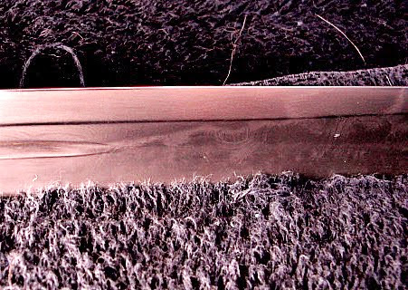

Greetings Everyone,

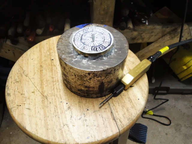

I have been working hard on this one for many months. Making this one, and making it as a sole author, was a challenge. I spent several months learning how to engrave with tagane and with Western-style gravers. I snagged an Ngraver hammer handpiece and a low-speed, high-torque foredom to drive it. This, plus some hot glue and a 15lb shaft cutoff gave me the setup needed for engraving and adornment.
The blade is in the style of the Ming Dynasty. There was clay heat treatment in China as well as Japan, though there was less by the Ming than there had been earlier. Still, this bit of license really enhanced the esthetic appeal of the blade.
It is a sanmei, with the outer plates each having about 720 layers of 1020, low Mn 1075, and W2. The center core is W2. There is a very active shuangxue (snow crystals - hamon to the Japanese school), and a nice, subtle pattern in the steel.
The sword is 27.5" working blade length, and should weigh just about 2lb. I haven't weighed, but the blade weighed about 26oz. This is a light and fast blade, and would be good for someone to do cutting and forms.

Fantastic! Definitely one of the nicest things I've seen pop up in the sword forum lately. The blade is gorgeous. If I had to pick something as a critique, it's that the blade looks awfully straight to me, and even a liuyedao should have some nice curvature, as the forms are primarily for cutting. The pommel end looks interesting to me as well, lacking the traditional downwards curvature again, which may just be the angle of the photo. I'd love to see another picture, of the pommel end of things. It's apparent that your sword-making skills are well beyond mine in most, if not all, respects, so please take my comments as coming from my side as a practitioner of Chinese MA. Great looking piece. Are you going to make a traditional scabbard as well? If so, I'd love to see what you do with the chape. I've been trying to figure out a relatively easy way to make one. Thanks for sharing!
Thanks for the comments.
Crimson - you are correct on all points. I handled some earlier swords, and they (Ming) seemed straighter and had straight handles. This shape is a departure from true willow-leaf, and I probably should not have called it that. Thank you for your comments.
kc
Kevin, I've followed your journey far a long time. I've seen and read about many of your success's and failures. So, from the perspective of a man who makes swords not nearly as good as this one, one of the things that struck me right away is the dragon engraving of the guard. It's just not..it's got a ways to go. I don't understand the shape of the guard itself (and that's probably because I am not familiar with Chinese swords) but why is it shaped like a lid, with the hollow part facing the blade?

Thanks David. The guards are supposed to be exactly a lid. They cap the sword within the scabbard. Standard design for Ming and Qing blades. As for the engraving, well, this is an art unto itself and will take a great deal of time to master. I just started the engraving this year, while I started making blades in 2008. Hopefully, my skill at engraving will move at the same speed as my blade making.

Did the uneven fullers happen after polishing? (3rd photo up from the bottom). That's happened to me and the thought of trying to even them out is demoralizing knowing the time involved... fix one then the other back and forth until they are under the "habaki". :p
Love the "hada".

Stuart - the little bit of difference did in fact happen during polishing. It is a big deal to make sure that the fullers don't go under the blade collar (tonkou or tunkou for the Chinese). So, I just left that little difference. Thanks for the comments. I have liked your recent work, too.
