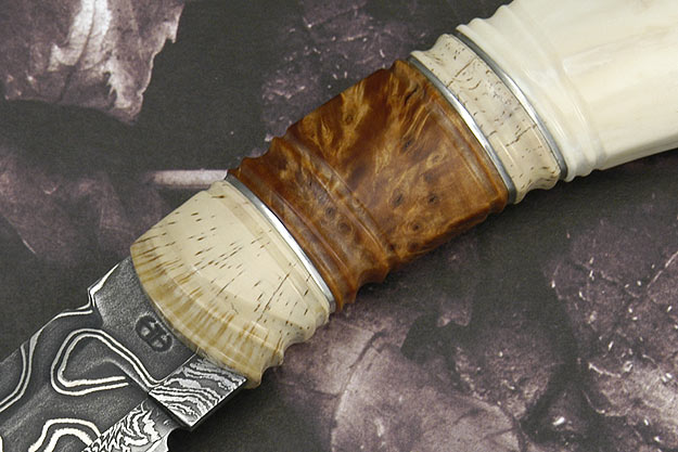

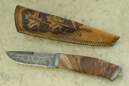

Looks fantastic to me....
Willow Burl Hunter
Willow Burl Knife
Warthog & Willow Burl (stabilized) Puuko
Willow Burl Vessel
Willow Burl Bowl
Black Willow Burl Bowl Blanks
Spalted Quilted Willow Burl
