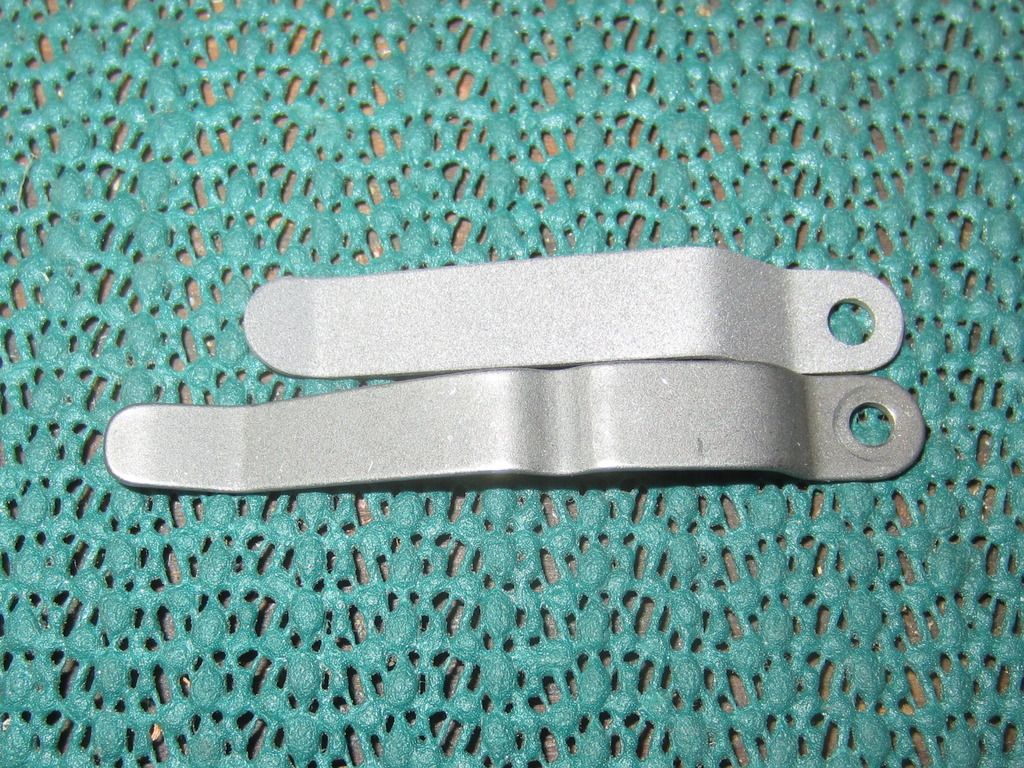

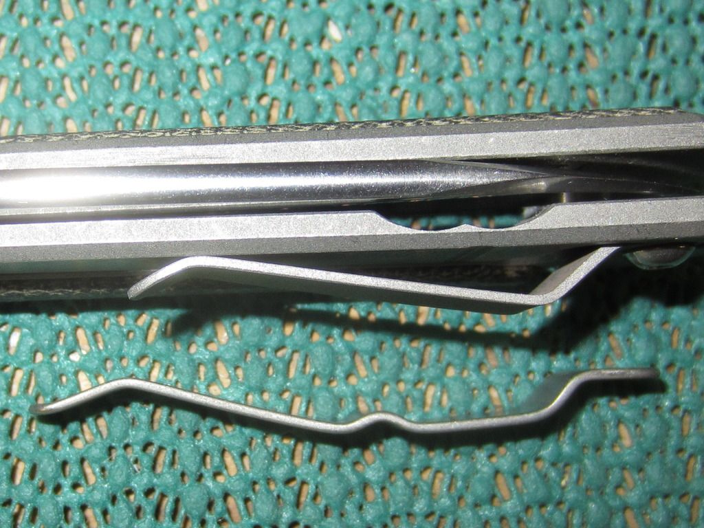

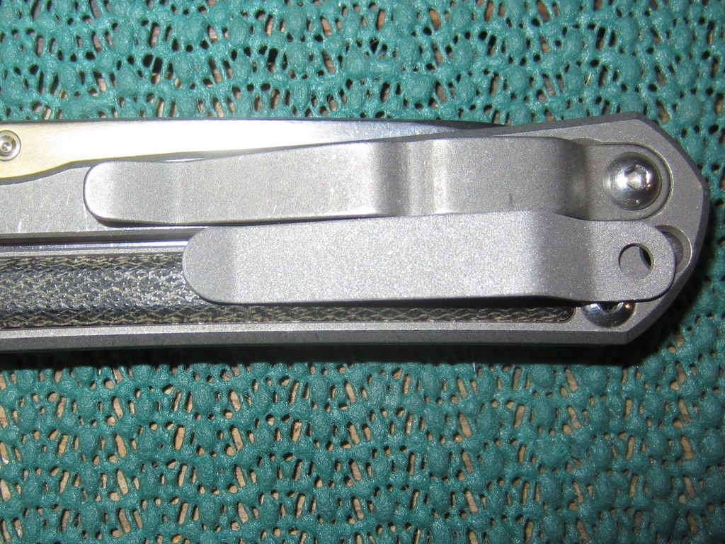

Inspired by dweglarz13, with his shortened standard clip, I made clip from scratch. It's shorter than stock and of .032" thick titanium(a little thinner than stock).
It's a three bender, unlike the stock clip.
I'm perfectly happy with the stock clip and will continue to carry the stock one, but wanted to see if I could do it. Done!

Thanks!
I used aluminum oxide to blast, it's quick and easy to get the gray look.
Yes it does appear thicker, but I miked them. The CRK's edges are eased more I guess.
