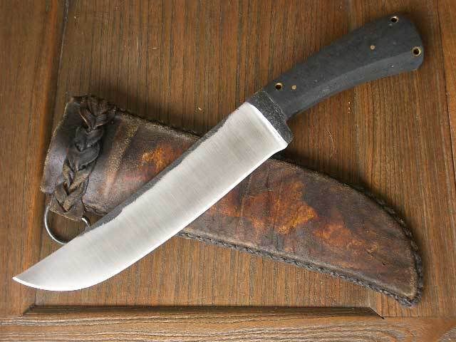

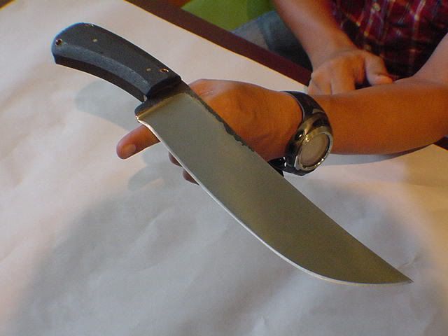

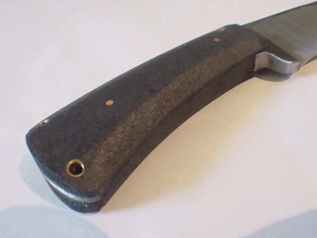

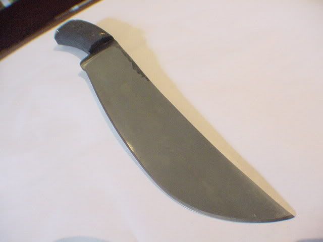

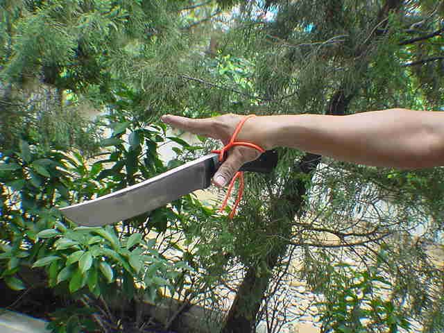

WOW! Is that a tapered tang?
What is steel?
THANKS FOR LOOKING.![]()
The Knife Santi posted was forged from either 1086v or 52-100, Probally 1086v. The tang is a modified full tapered designed to throw a little more weight forward to help with heavier cutting events. Below is a picture of a different knife that illustrates the tang design.
