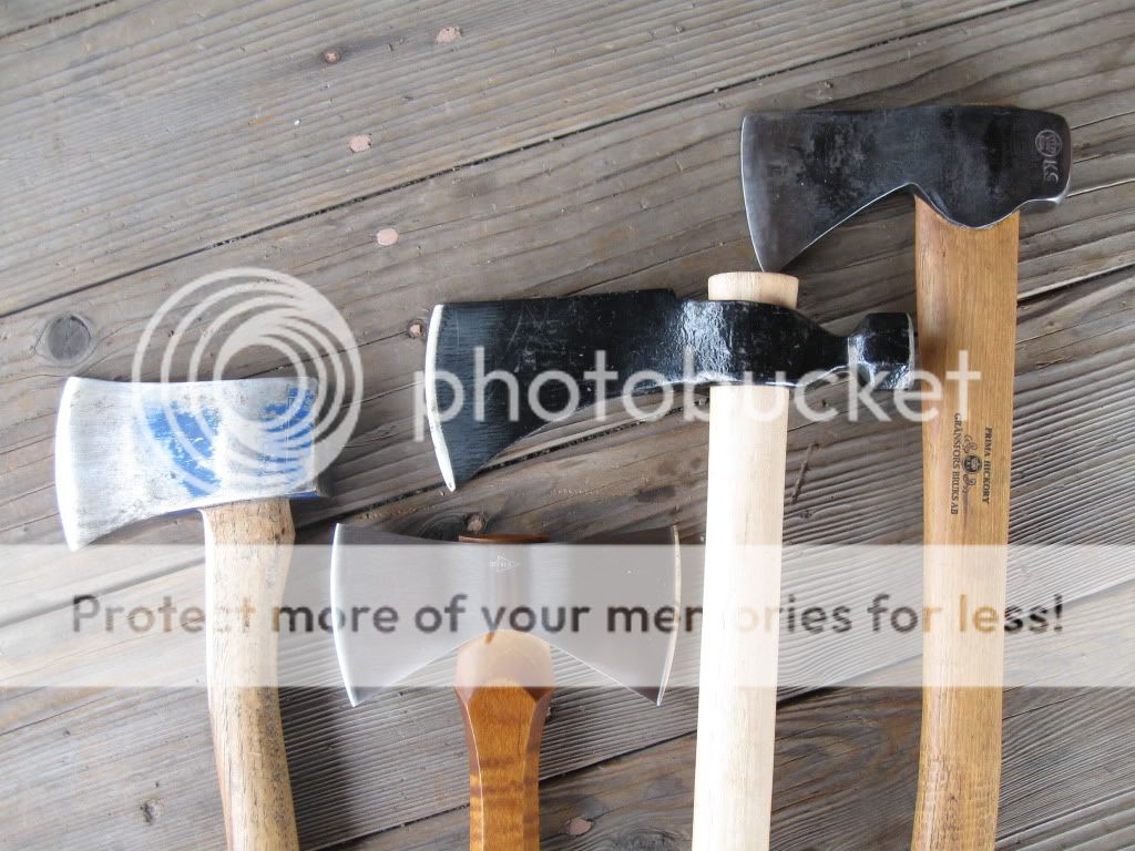

The bit isn't much thicker than the Trailhawk and it weighs over twice what the Trailhawk does.
It weighs more than most hatchet heads also.
The bit is thinner than the GB Hunter that I have.
It's a lot hawk for that size handle.
Chops pretty darn good.
It's a beast as far as Hawks go IMO.
I have a lot of hawks but for all out wood processing the one on the right would do he best out of my hawk collection
Steve from Coal Creeck Forge made it
