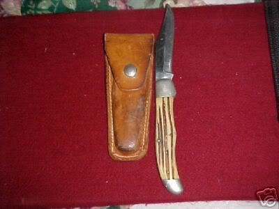

The one I posted is a queen on eBay right now, estimated '50s-'60s I think.

Redshanks, your top knife is actually winterbottom delrin, 1990's era. Your bottom knife is a Queen too, with real winterbottom bone....from about 1960 to about 1971, Queen did not use tang stamps, only blade etches, and the etches would of course wear off....since yours is real bone, it dates to the early 60's.
Codger, as far as I know, winterbottom bone was only used by Queen, Case (rare), and Utica (also rare)....I have seen and owned may bone handle Imperials 1920's 1930's era, and all that I have seen have had conventional jigged brown bone handles.
I think that the Winterbottom company actually offered a number of bone stlyes, we just know the "Queen" style as "Winterbottom", probably since its distinctive and they were the biggest user.
