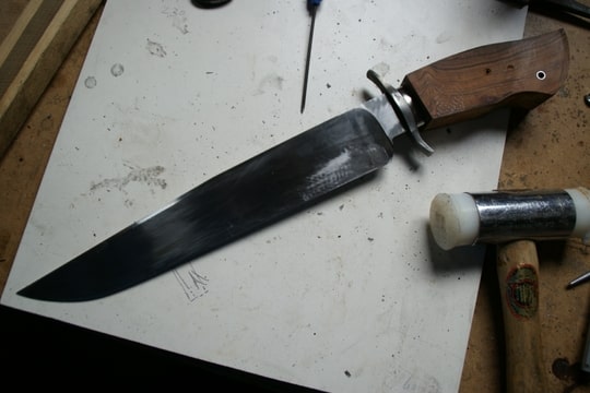

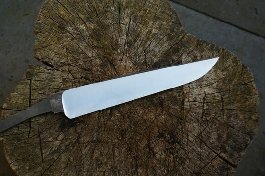

I am working on a bowie with a 31 cm long O1 blade, damascus fittings and a Desert Ironwood handle.
Here are the results so far.

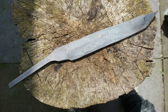

Forged.
Ground the outline and the flats
Ground te false edge and shaped the ricasso.

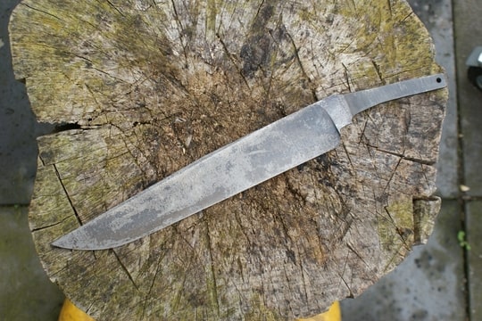

Hardened and tempered.

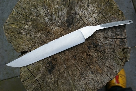

Start finish grinding.

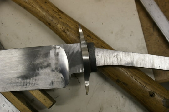

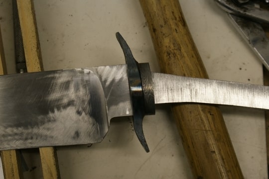

Piece of damascus for the S-guard.

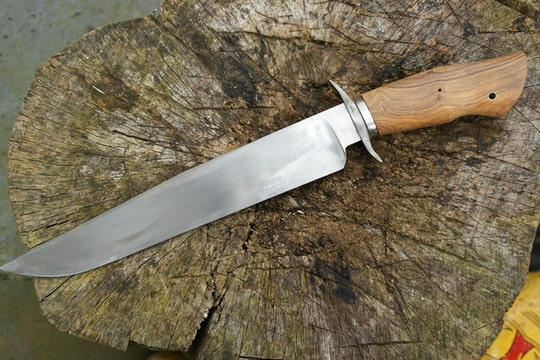

Guard and spacer shaped and fitted.
Guard bent.

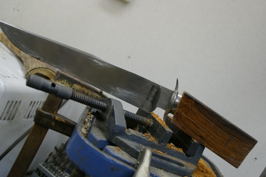

Handle fitted.
Hope you like it!
that handle doesn't look very ergonomic : )
The man with the wooden shoes strikes again! ;)
That's going to be a nice one again, Erik! Can't wait to see it finished!
Kind regards,
Jos
Now that you mention it...........I now see there is some work in the handle to do, thanks for the heads up!:thumbup:
hey, I'm just here to help! : )
Back from a week in Germany.
This afternoon I fitted the handle against the spacer and the holes for the pin and the lanyardtube.
Roughly made the contour of the handle. Less blocky....
