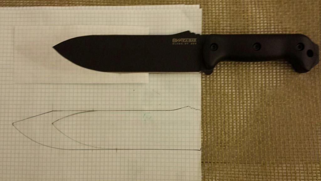

Here's my plan for a 7" BK9.
From sketch to reality ...
... almost! ;)
Man, is that tip going to be thick! Any recommendations before I start cutting?
That will be awesome Travis if you do that mod! Go slow. You will probably want to use a cutting wheel to get the majority of the work done. A dremel with the black cutting disc is what I like to use. Just take your time. I keep a bucket of water under the blade and a sponge that I dip in the water and set on top the blade. After every pass I just squeeze the sponge and it keeps the blade cool.
I want to make a short BK9 similar to that too. Love the width of the blade on the 9 compared to the others in the line up.
The tip will need to be thinned out though. I dropped one of my nines and took off about an inch and love it. I did thin the tip out some. Could go a little more but I kind of like it robust.
