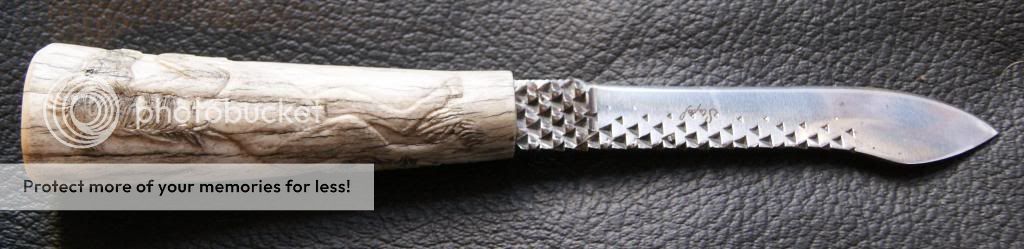

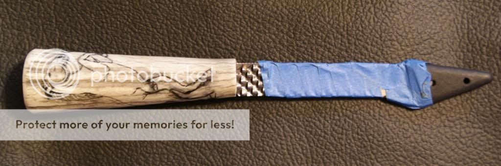

[FONT=&amp]This is a Mountain Man Knife made from ferrier's file. This is going back to Chuck Stapel when finished.
Here's a picture before I started.
[/FONT]
[FONT=&amp]

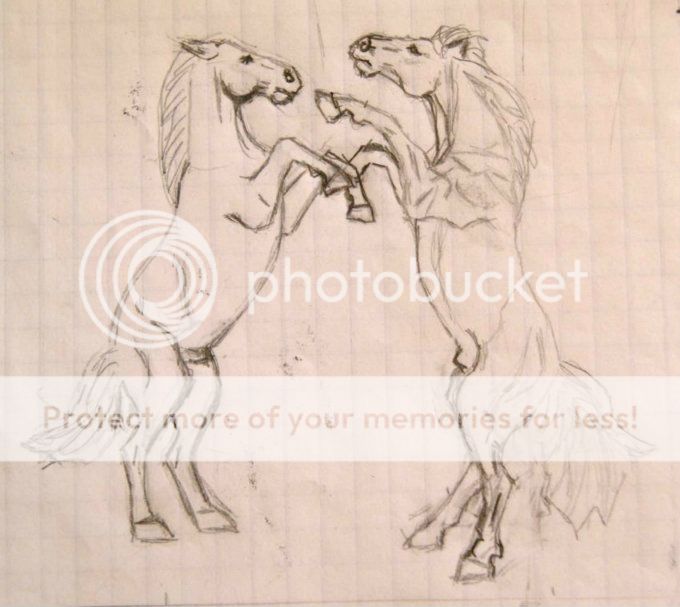

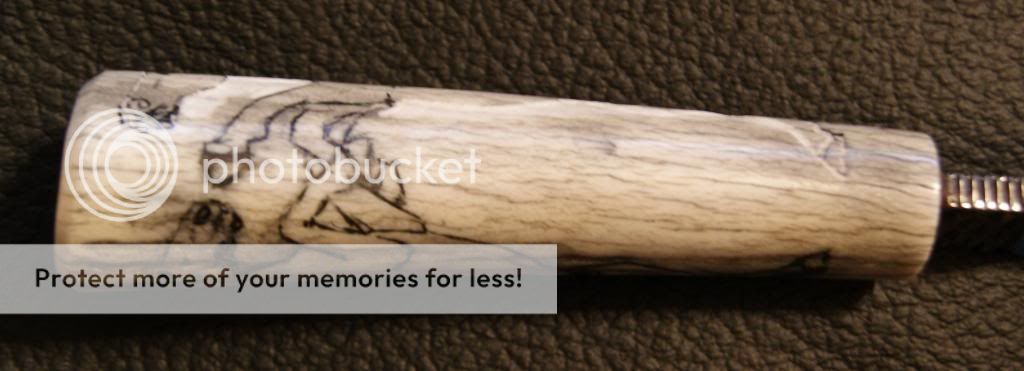

[/FONT][FONT=&amp]This is Elk antler. The next picture is the preliminary drawing for placement. I don't get into detail here, I actually draw the picture as I carve, this is just for position. [/FONT]
After I tape the blade, I transfer the picture to the knife. I make a copy of my picture, cut out the individual horses, tape them to the handle and trace around them. I save the plastic tips from shipped knives to use on the tip of the blade, which always seems to poke thru the tape.

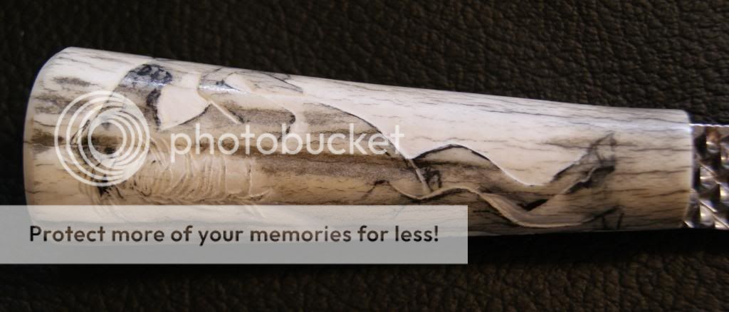

I start cutting along my outline. I hold my tool vertically and use it like a pen to add detail or fur or I hold it horizontally to remove background, smooth & shape the stag.
More to Come! Comments Please.
Cathy
More Pictures...

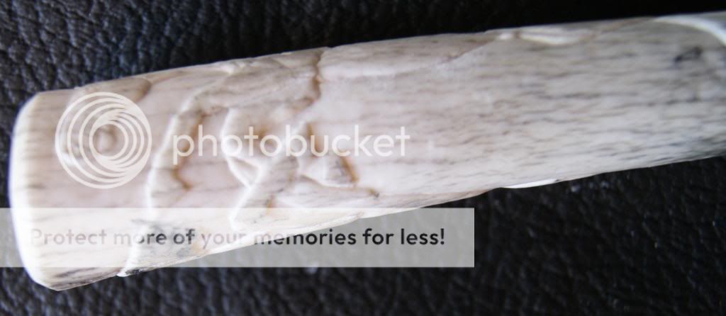

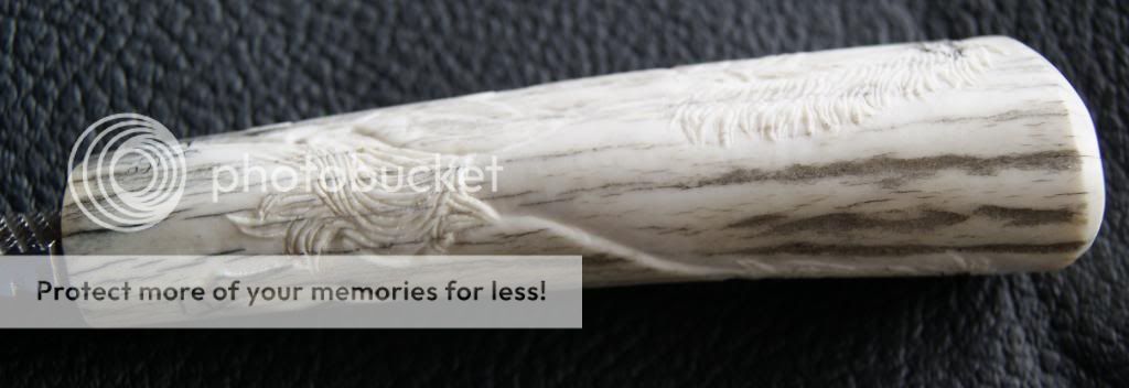

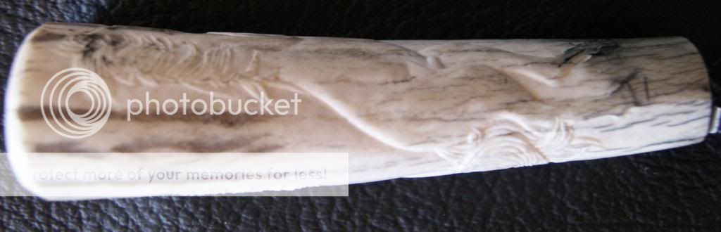

To make the picture POP! I do two things;
1. I remove stag from the background to raise the picture
2. I undercut the picture. I use a broken tool that I sharpened to a needle point and holding it horizontally, I cut along the edge of the horse, like using spatula, getting under the picture.
Yes, it's anatomically correct.
The best way do describe my style is that I use my rotary tool like a pen and draw what I see. Like a pen, tattoo gun or graver, mistakes can't be erased. But, sometimes, mistakes can be fixed.

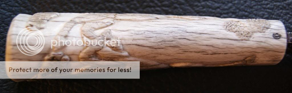

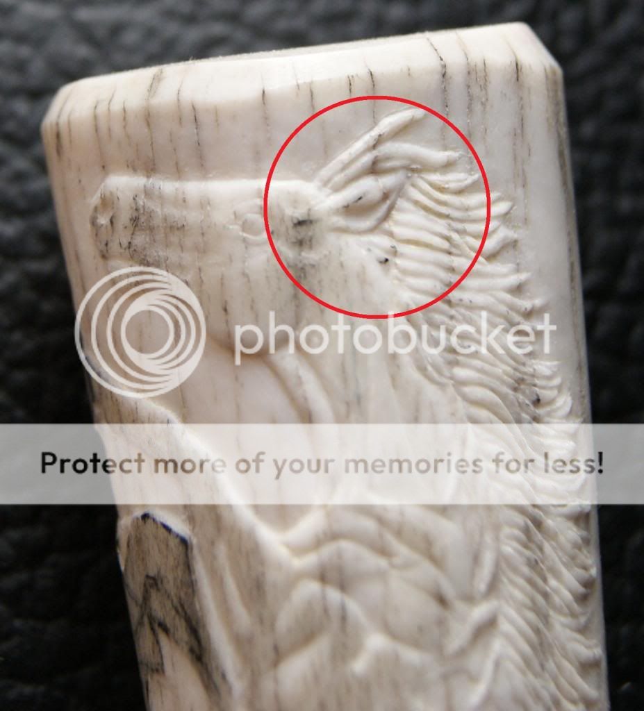

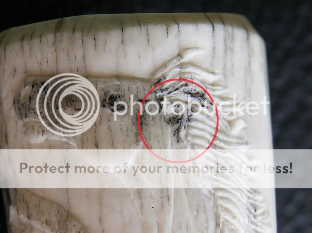

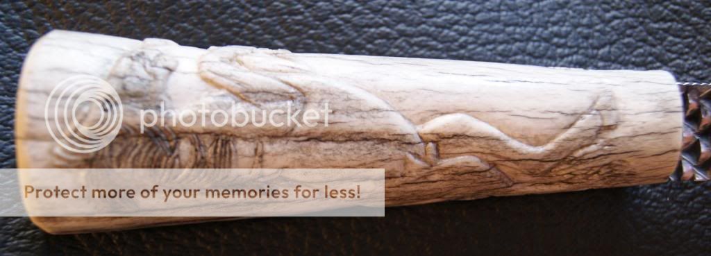

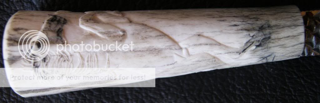

I wasn't happy with the ear on this horse. It was the wrong shape and in the wrong position. It looked more like a wolf ear and needed to be moved closer to the top of the head. Problem is, I started carving the ear, in the wrong position.
Before Fix -
After Fix -
http://www.bladeforums.com/forums/newreply.php?do=postreply&t=1017266
To fix this I had to smooth out the old ear, cut the new ear and blend in the horse's hair. I also did some more work on the face, as you can see in the 2nd picture.

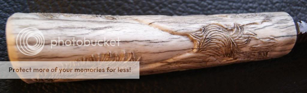

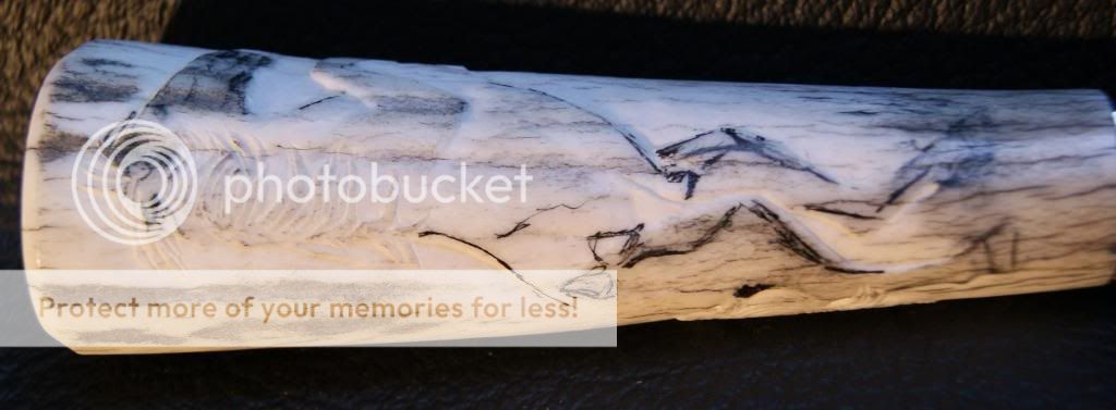

Thank you for the great comments, Brian, Jos, Xander, Peter and David! Here's some more pictures...

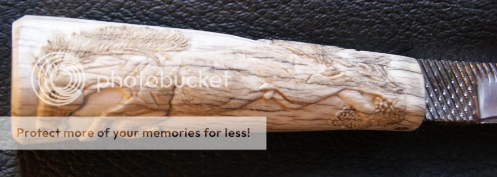

Stag, Bone, Ivory etc. will burn if you force the tool to cut faster by applying to much pressure. Let the tool and machine do the work. If the tool starts chattering, turn the speed up. I use bits that are 3/32" & 1/8" in diameter. I'm cutting down to a depth of approximately 3/32" to 1/16". I use a magnifying glass and reading glasses while I work, so taking pictures and posting them online is a big help for me. I really love the natural color and lines in this antler.
I'm suppose to keep track of the amount of hours I put into these knives, but I don't because it would make me sick. I drive my husband nuts because I have so many hours into each one. He says I need to work faster. Attention to detail has always been my style and therefore I work until I'm satisfied. This knife has to be my best, because I want to impress Chuck Stapel.
Here are some of the tools I use.
This one is my favorite. I use this to outline, remove material fast, smooth out the stag, and add fur, or in this case, the mane.

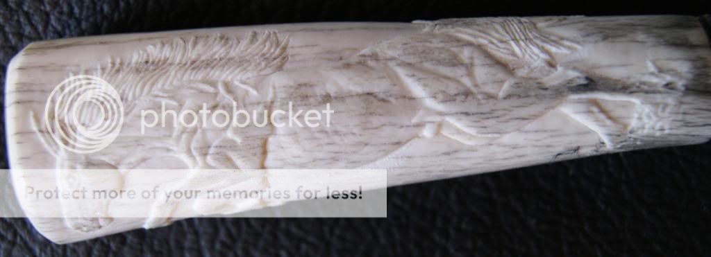

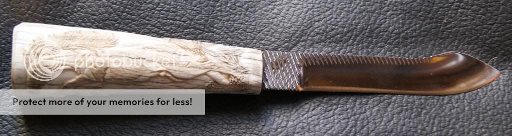

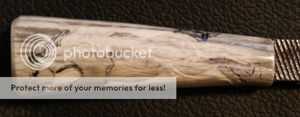

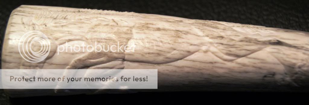

Almost finished!

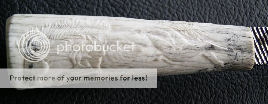

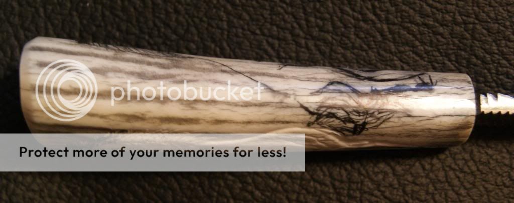

Here are the final pictures.

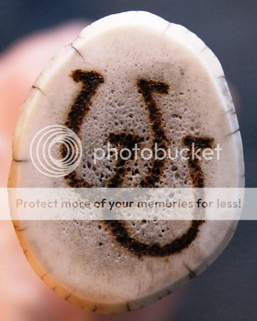

I used a colored wax to stain the piece. I also used some black tattoo ink with the wax on one of the horses to make it look different from the other. On the pommel, I burned a double horseshoe brand into the stag.
I was given artistic freedom with this knife, but Chuck Stapel suggested putting brand marks on the handle like the ones cowboys burn into their livestock. I thought that was too easy, so I used my husband’s idea and carved fighting mustangs instead. The blade was made from a ferrier’s file and the horses fit the theme. Adding the double horseshoes on the pommel includes a piece of Chuck’s vision for this knife. I'll be sending this out ASAP. I'll post Chuck Stapel's comment's when he gets this.
So, What do you think?:)
