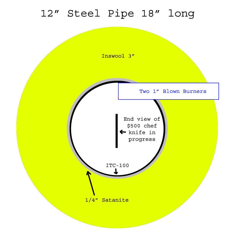

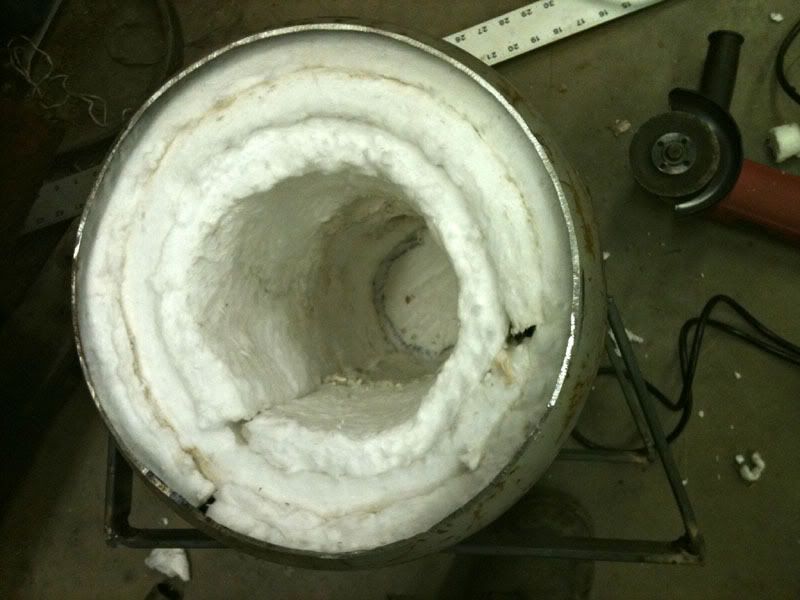

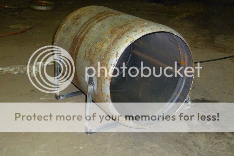

Alright so I've been browsing and questioning you guys a lot so I decided to start a Forge WIP. Although progress might be quite slow and steady as I acquire materials I need I will try to post everything as I go.

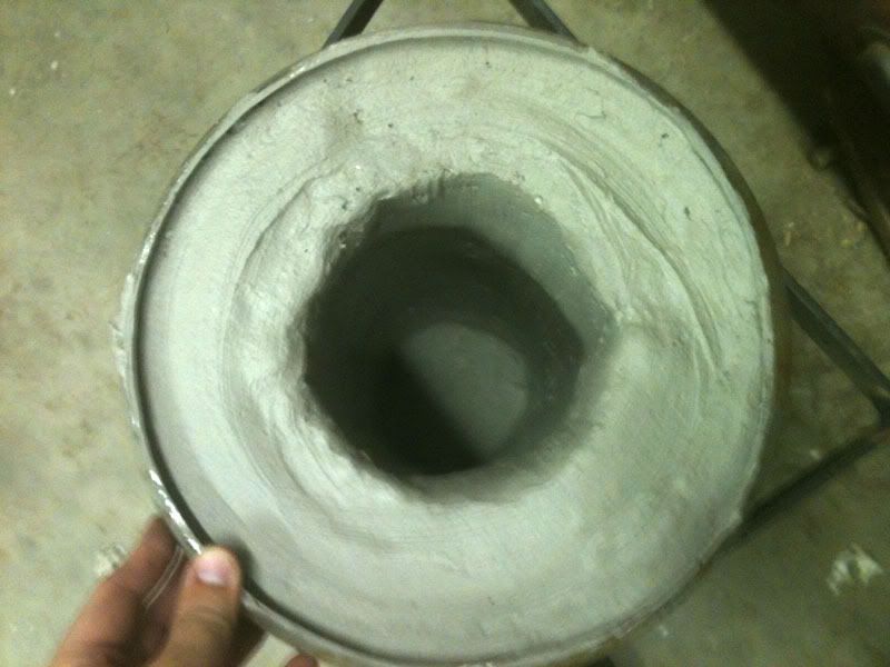

The basic forge design is a 12" x 18" cylinder that will have 3" of Durablanket all around, a layer of Satanite, and a topcoat of ITC-100.

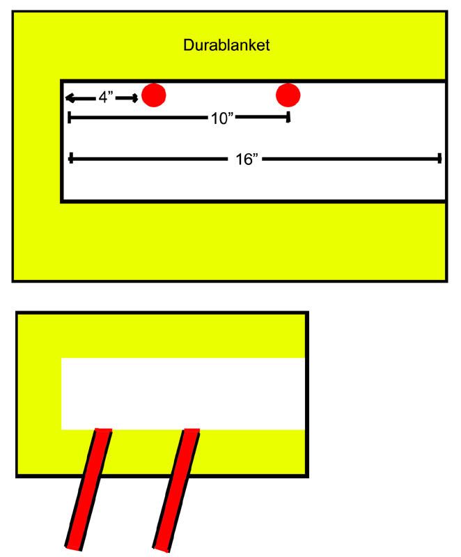

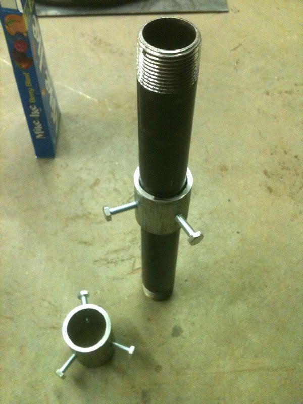

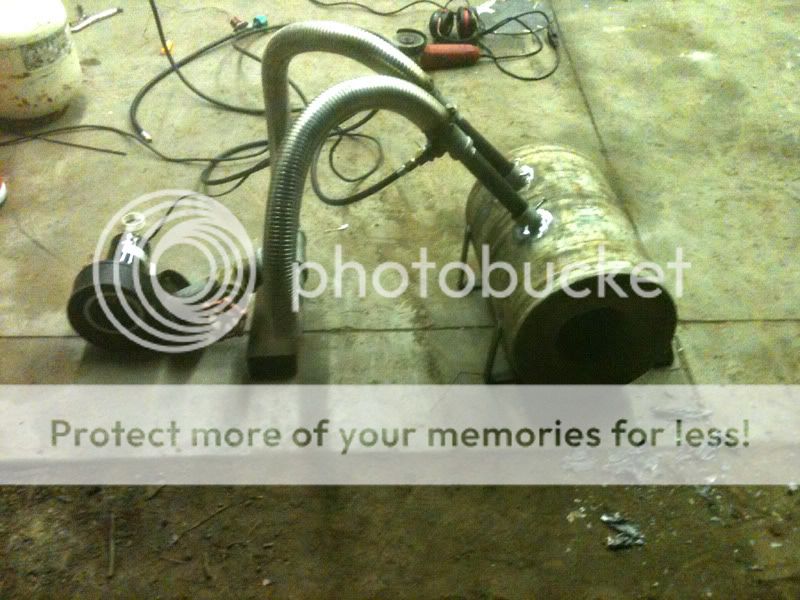

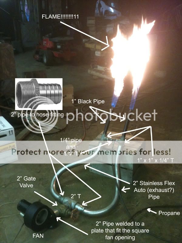

The Burner is a dual 1" black pipe blown burner. Here is my design with everything labeled. The SS flex pipe came from autozone and I used it so that when I have the burners mounted in the forge I can set the fan basically where ever is convenient.
Right now I have the gas just going into a 1/4" T that splits it between the two burners, but after I am done I would like to have it set up with individual needle valves for each burner so I can adjust it however I want. The problem that I am having is finding 1/4" needle valves at a reasonable price...all I could find was the compression fitting 1/4" needle valve which is nowhere near the same size as a 1/4" pipe (weird how that works). Anyone know where I can pick up a few of the valves....or can I weld brass onto black iron?

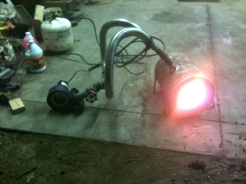

Here is a video of the burner. I don't have a regulator yet so this was done with the tank just cracked a bit.
[video=youtube_share;-3hbUK04bxo]http://youtu.be/-3hbUK04bxo[/video]
And this video shows the flame in the left tube starting just above the pipe. Is this caused by too much air/not enough gas?
[video=youtube_share;WIzHc99R4lQ]http://youtu.be/WIzHc99R4lQ[/video]
So....... Hows it looking so far?
