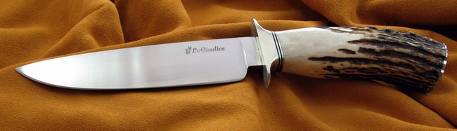

Almost completed knive. Just a little handle buffing to go:
Finished Knife. I'm working to get better photos:
Specifications:
Style: Drop point
Overall Length: 11-3/8 inches
Blade: 5-5/8 inch, Hand ground CPM S30V stainless steel, flat grind, 400 grit hand rubbed finish
Handle Material: "Popcorn" Sambar Stag Antler
Guard: Double guard, nickel silver
Spacer Material: Nickel silver and black vulcanized fiber
Butt Cap: 416 stainless steel​
Mike L.
http://www.logiudicecustomknives.com
