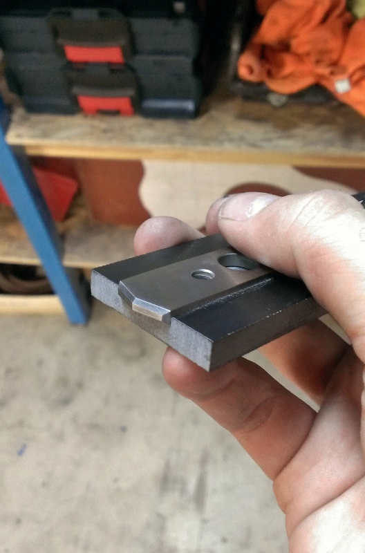

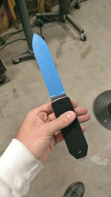

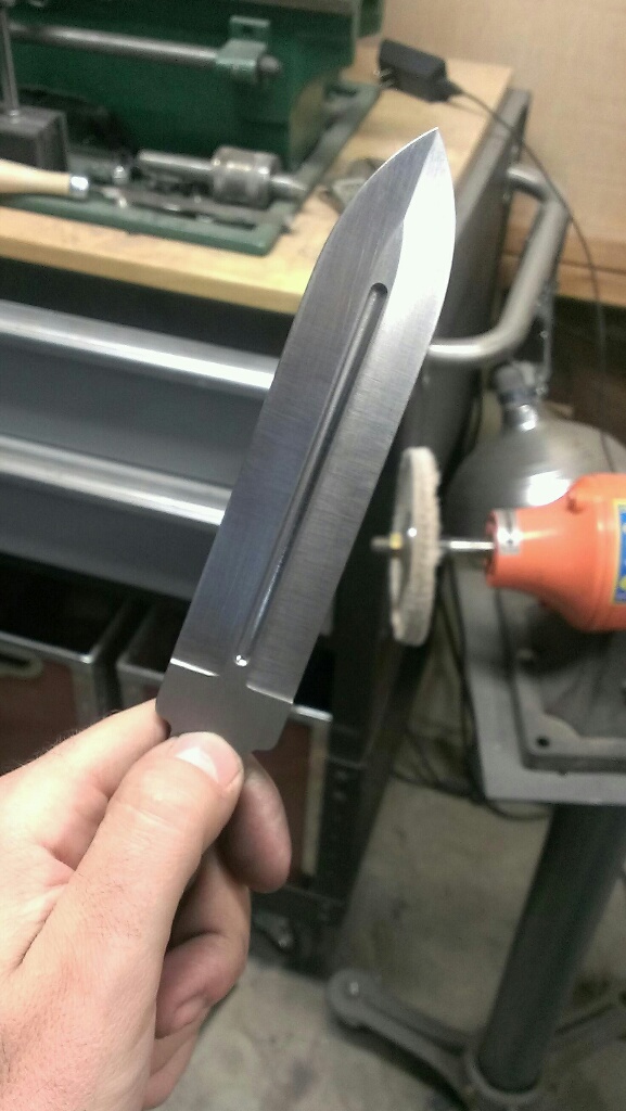

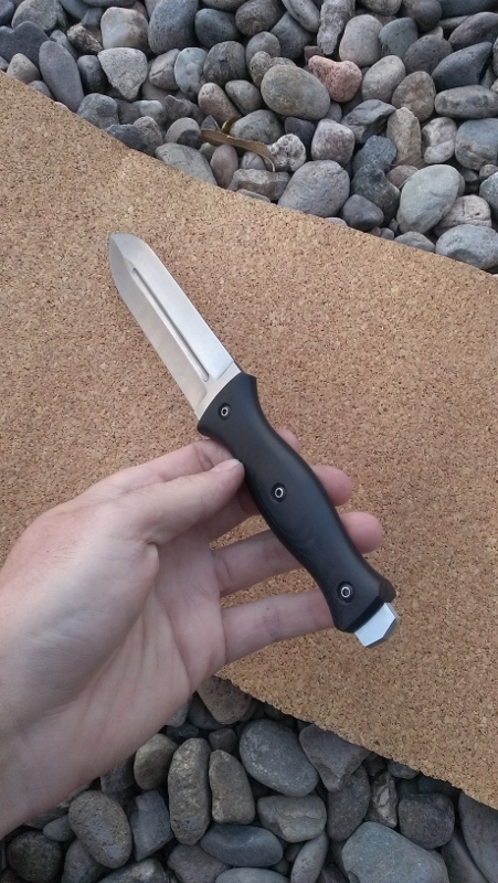

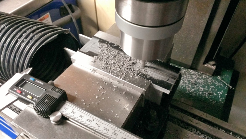

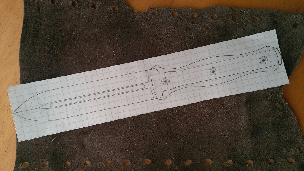

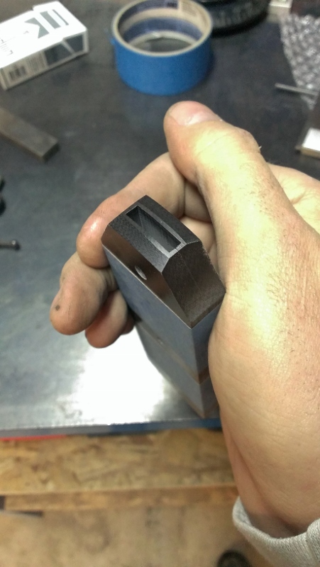

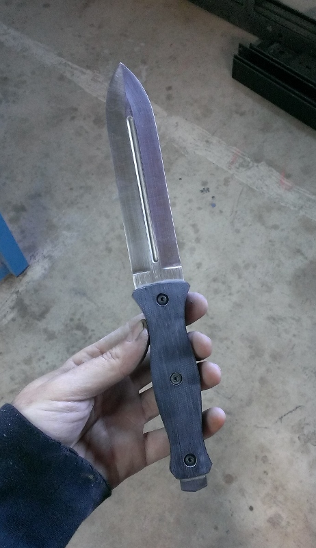

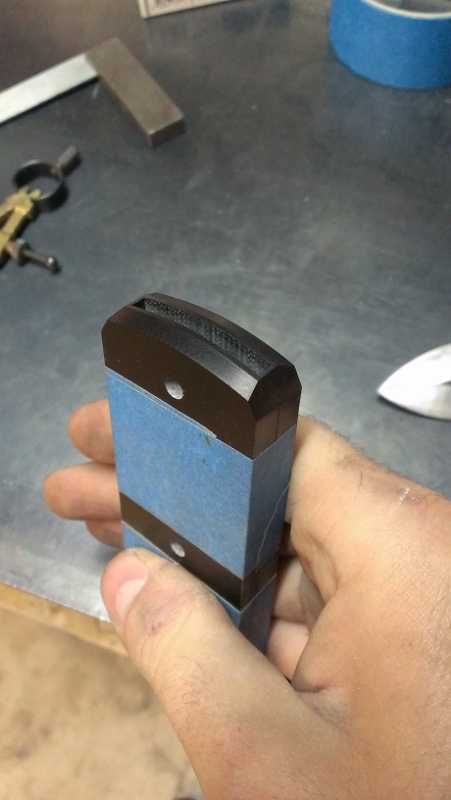

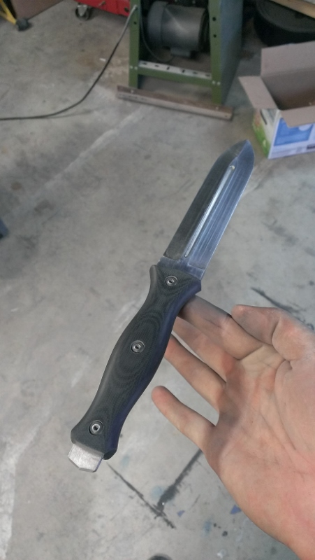

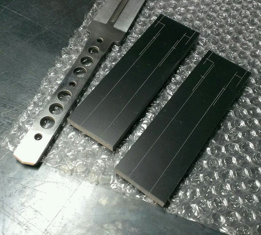

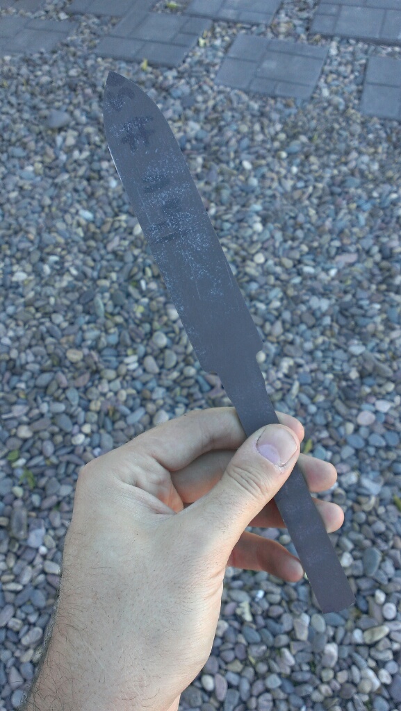

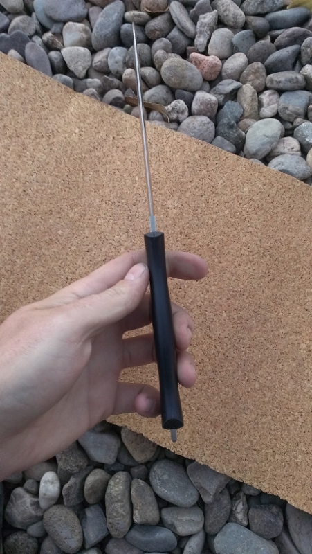

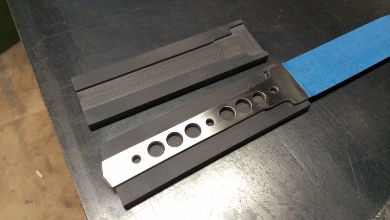

This is a commission for a good friend who is a firefighter. He wants a heavy duty fixed blade for self defense and rescue. His requirements were full tang or through tang, and he absolutely insisted on the fuller, which I will be doing with a 3/16" carbide ball mill. The handle will be clamshell construction fully contoured black G10, with the tip of the tang protruding as a glassbreaker. He would like the dagger blacked out, but I'm not sure how I'm going to approach that yet.
This will be done on the 10" wheel, so the bevel will be a slightly hollow scandi type grind. He wanted the dagger to be narrow but thick, and insisted on the fuller, so this is the best compromise I've come up with for his wishes:
This isn't really my personal style, but I still like some tactical knives for what they are, and look forward to completing this project.
