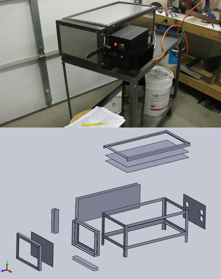

First up, I have to show off again the kiln I just finished! It was a first of many things for me and it's working great so far.

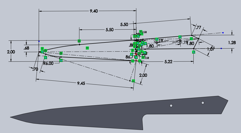

Moving on, most of the knives you see are based somewhat off my designs in SolidWorks. They are still slightly custom though so the templates only act as starting points. The designs have been touched up slightly from these but you get the idea:

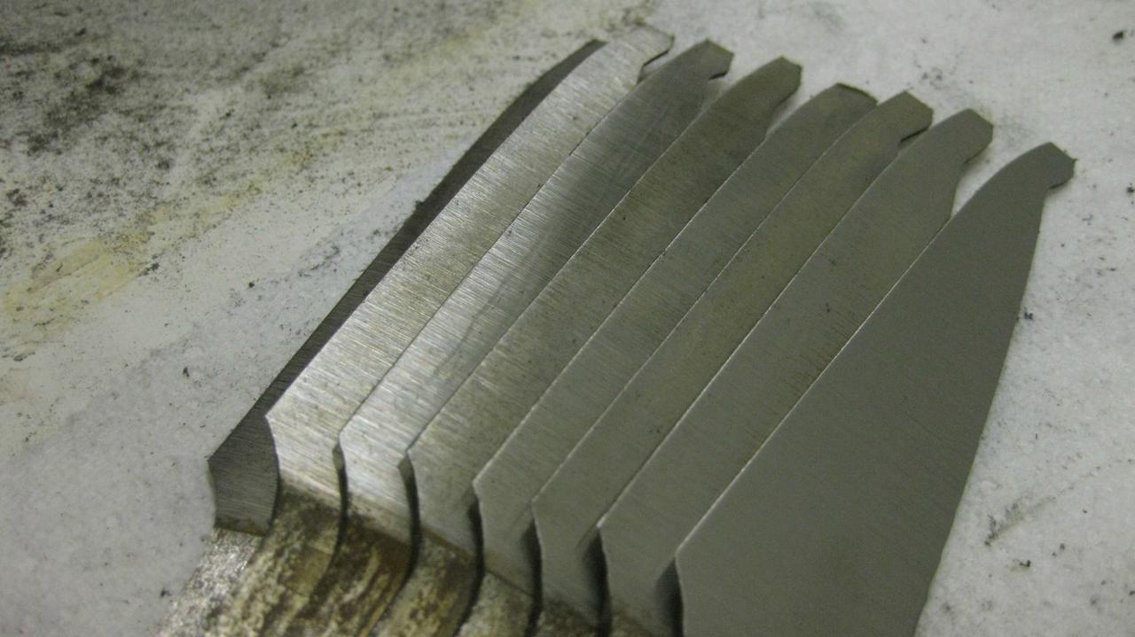

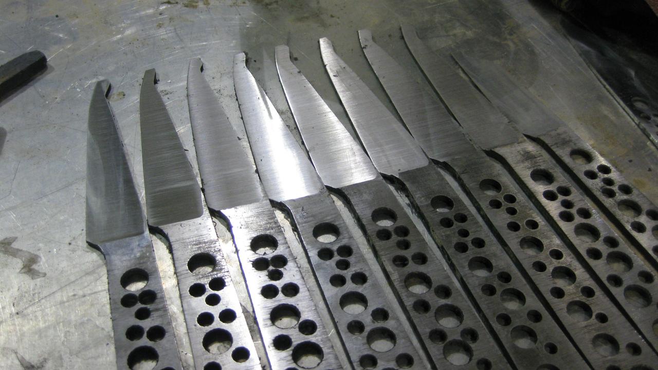

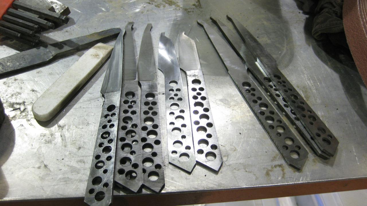

Here are a bunch of the paring knives I have laid out. There are a couple of stubby ones, we'll see how they turn out...

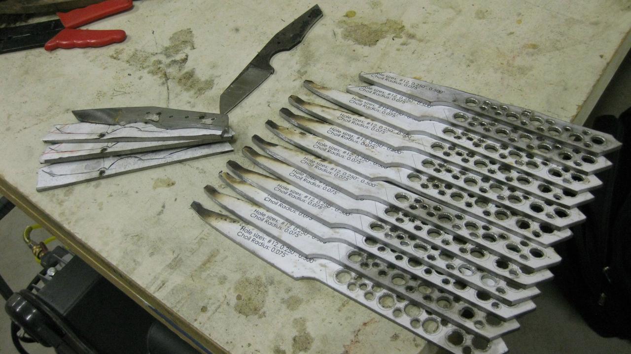

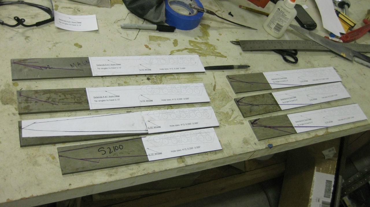

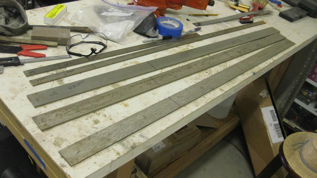

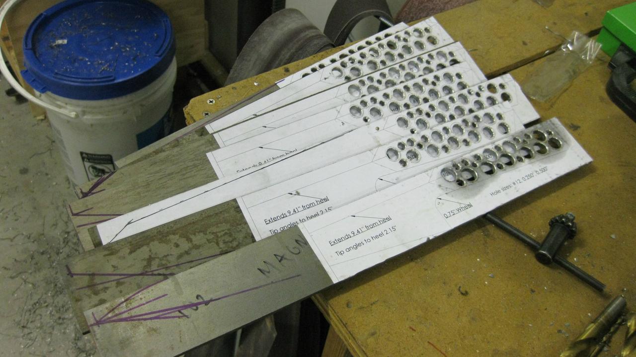

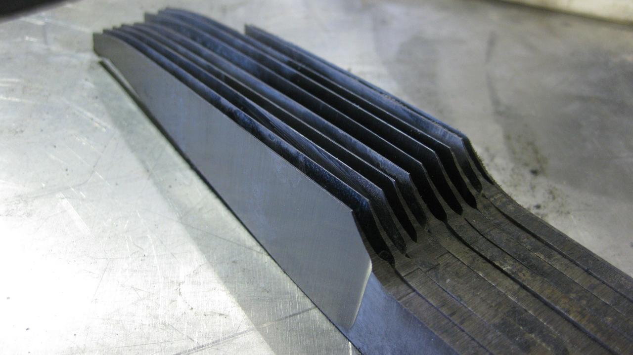

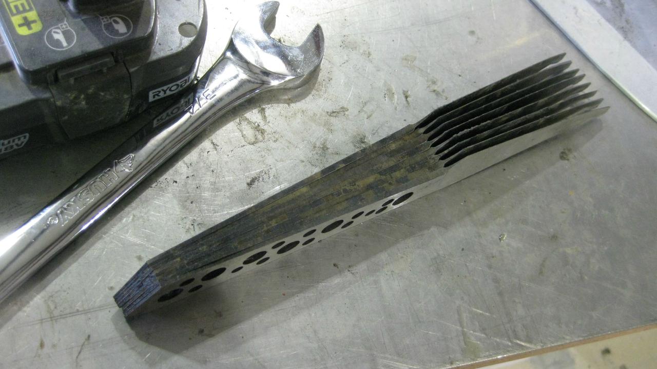

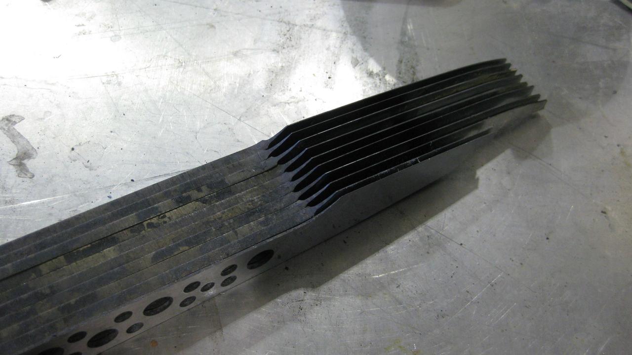

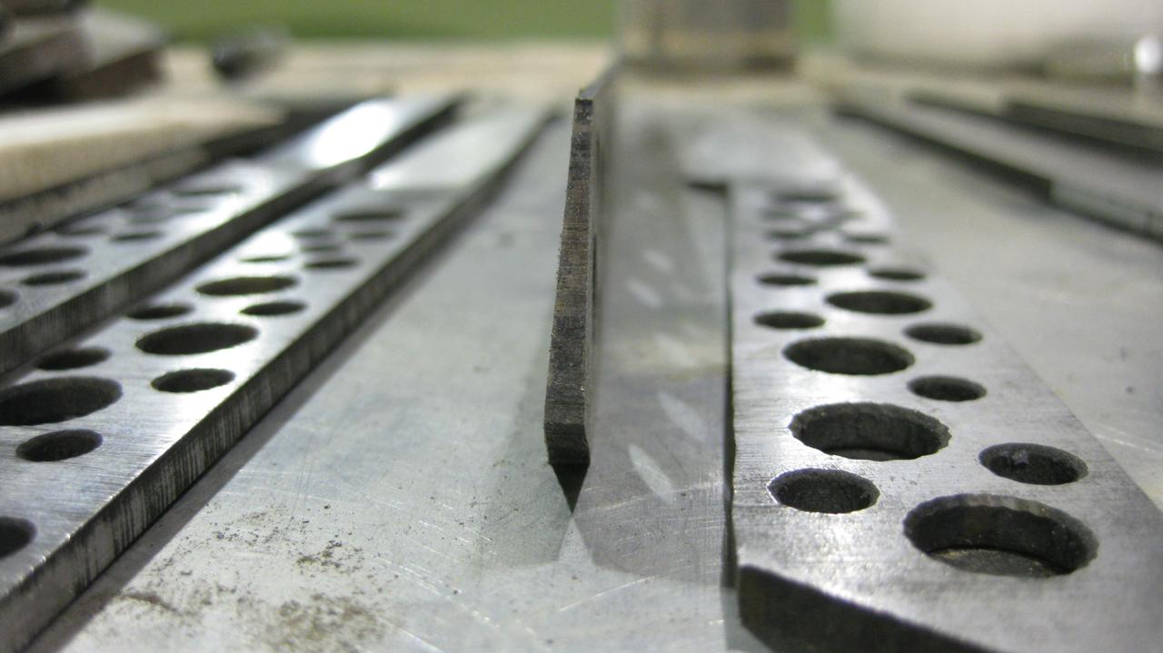

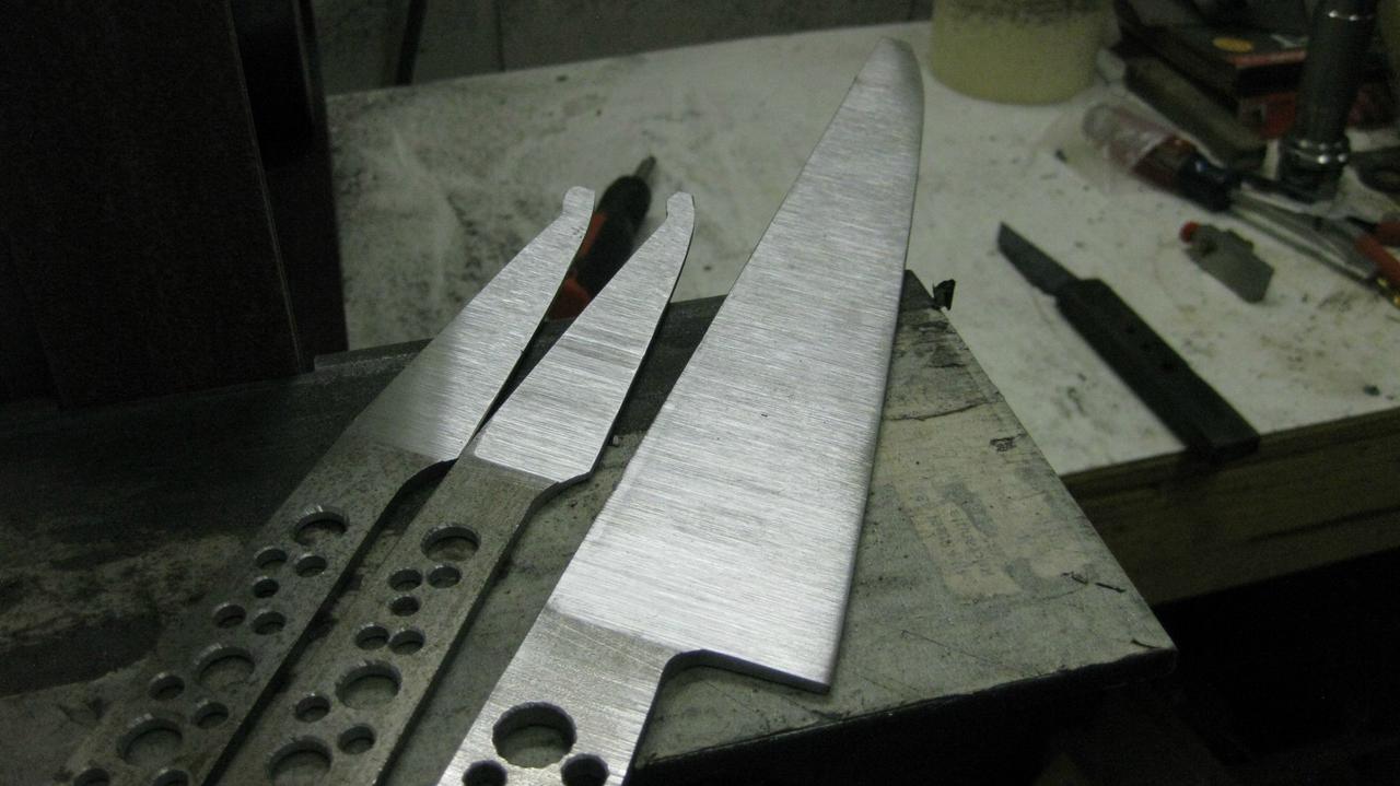

Here are materials for the gyuto and the templates on them. Makes it easier to drill out the tangs. In the future I will get them waterjet but for now this will work.

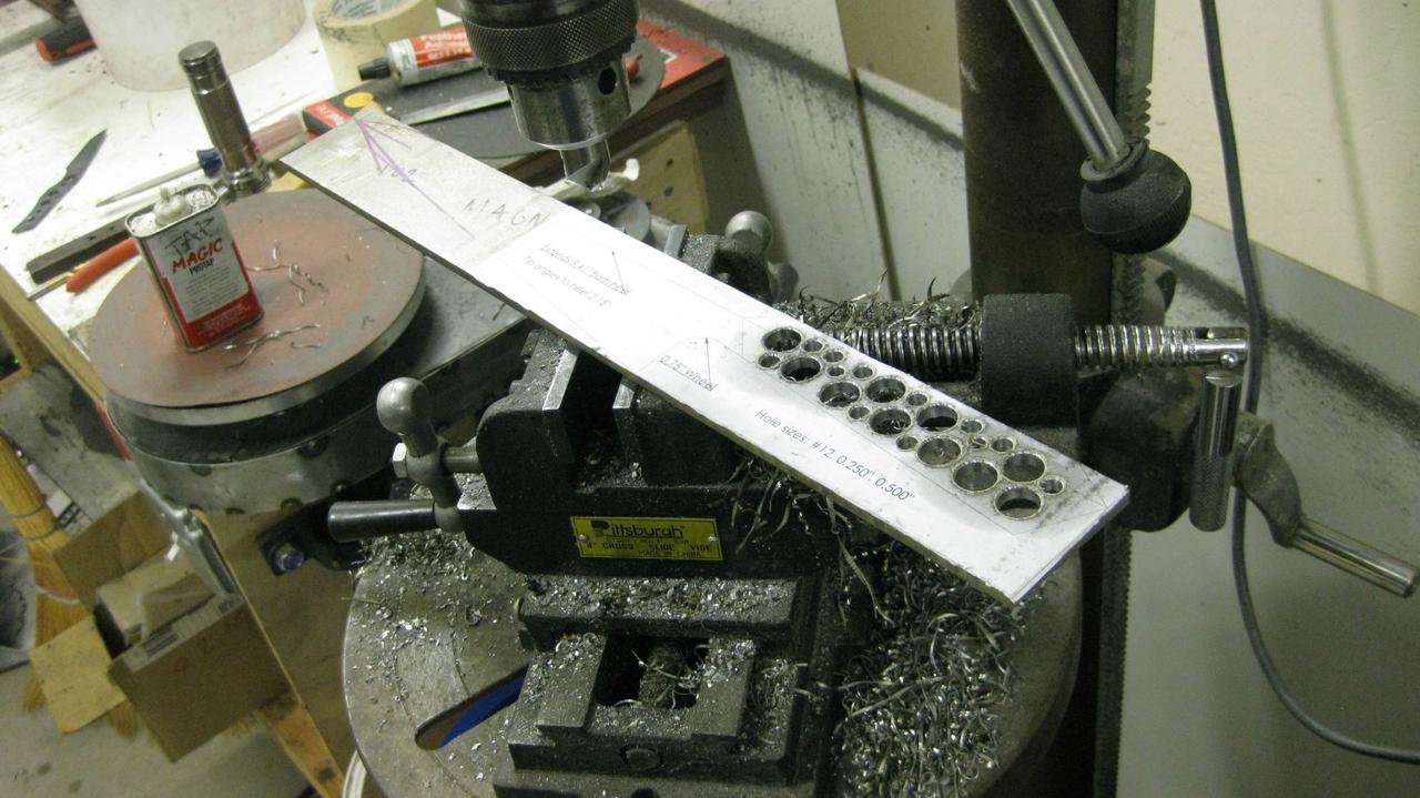

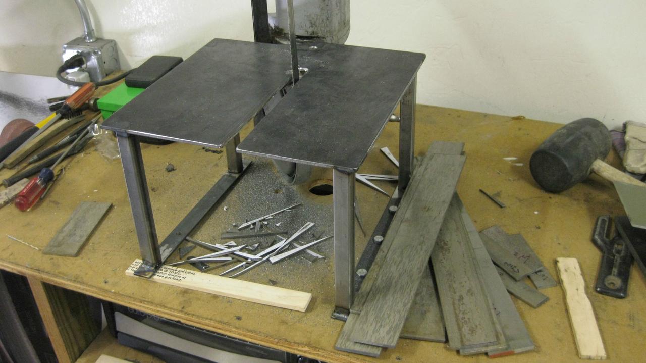

A couple shots of the drilling and cutting area.

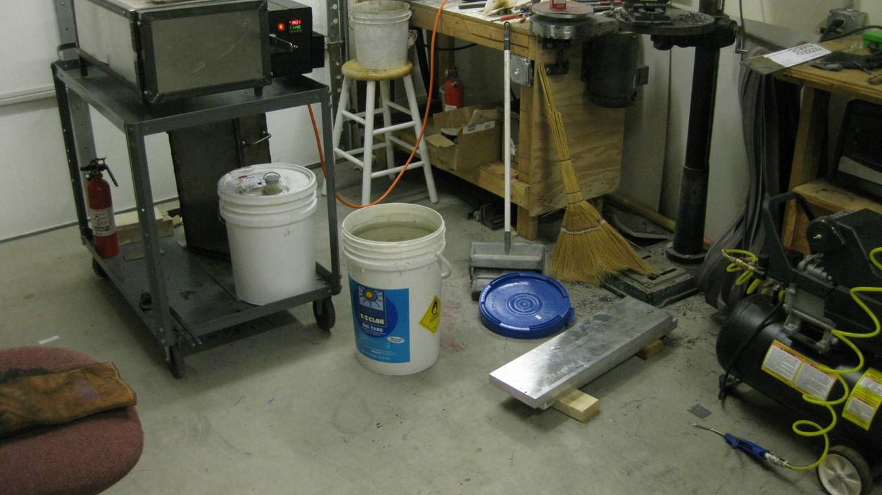

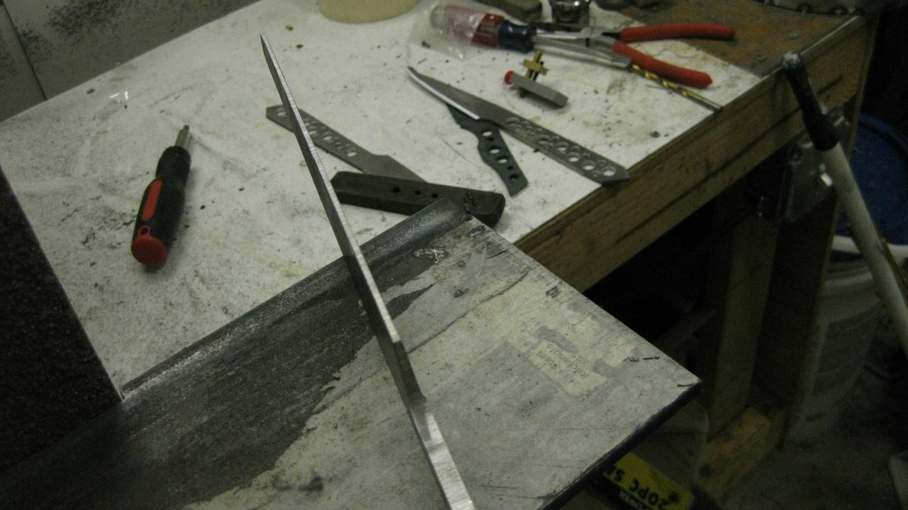

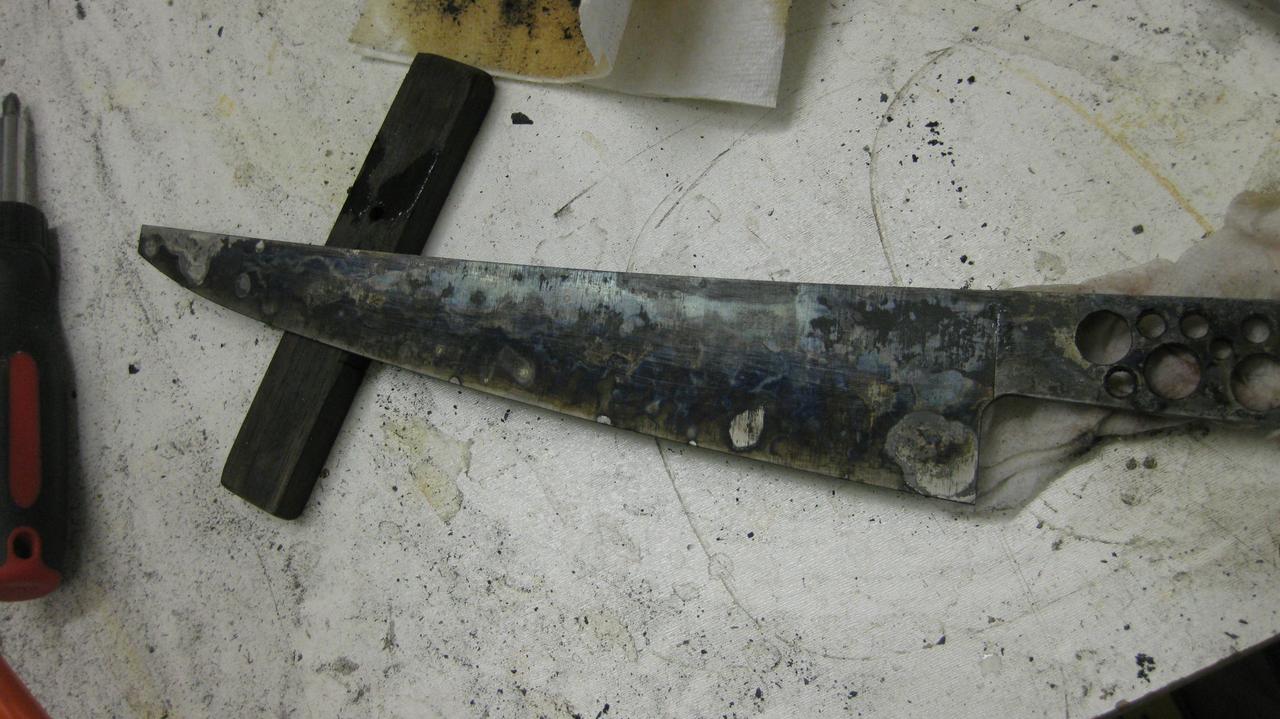

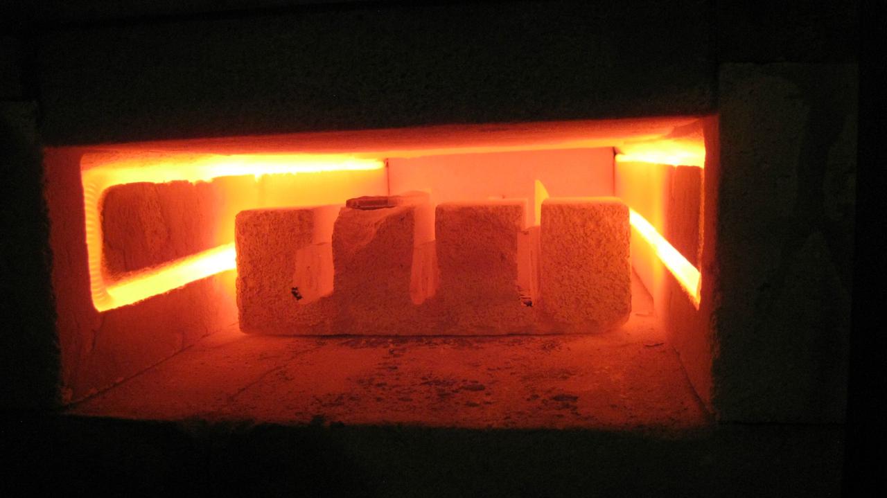

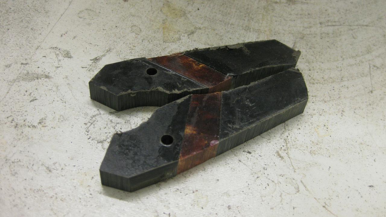

On the 52100 blades I quench them full thickness, but these few W2 are ground before HT.
Normalize from 1600° F down to 1400°F , then quench at 1450° F.
The idea is to do an interrupted quench: 2 seconds in the water and quickly to the aluminum plates and compressed air (apparently this may be a terrible idea as I am talking to some people about it).
Sori
Apparently the interrupted quench didn't help me out all that much, because there is this strange crack looking thing. It follows an actual oval shape right in the middle of the blade. I guess that's what I get for doing that weird water thing.

Thanks Salem! Drilling does take a while. I'm averaging about 25 minutes per knife, yeugh... It's totally worth it for me though until I actually do water jet cutting. I want the balance of these knives to behave like wa handles, and that's difficult to do with a full tang.

Drilling them gets tricky with the bigger holes. On these I drilled pilot holes on all them of first, then the pin holes, and eventually built up the other holes up to size. I use a speed chart and get as close as I can, otherwise it can get frustrating really easily.
All I have for quenches is water and the McMaster 11 second oil. I use the 11-sec for 52100 and water for W2. If I could I'd have a tank for P50 but I don't right now, so I just chant and pray before every W2 quench :)
I'm still figuring out the liquid-->plate quench. It seemed like a good idea in my head but there are many variables that are unknown to me and I'm only going off assumptions. At this point in time it's just an idea I'm toying with.

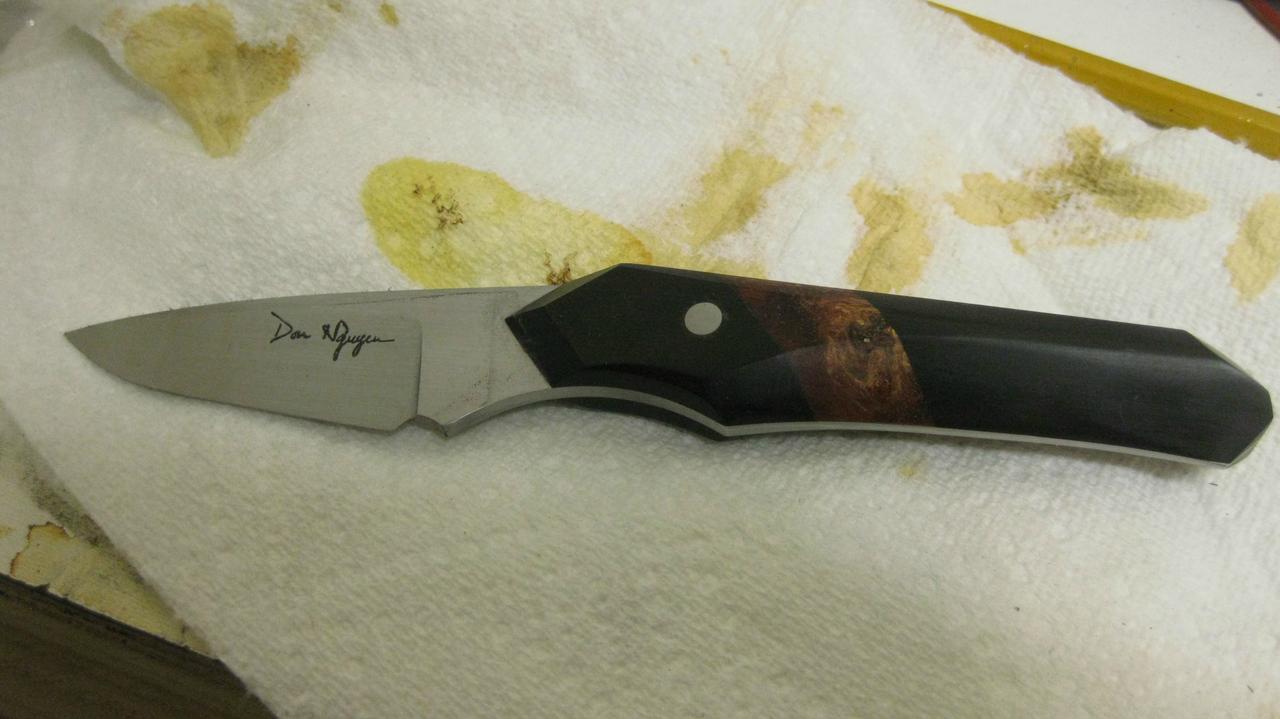

Bandsaw blade broke today and I have no replacements until tomorrow. Had to make a couple of modifications to the kiln and a few other shop things, but today was spent mostly working on a personal edc knife. It's a little embarrassing to make knives and not even have one to carry... :o
I seem to have the grind down fairly crisp and even, but I need to work on keeping the sharp lines when hand sanding; it's taped up now but the lines got blurred up. I haven't had too much practice with these types of knives yet.
Don, skip the liquid-to-plate quench stuff. It will never bring you joy.

Why do you say that about the liquid-to-plate? Not prodding or anything, I'm trying to learn what happens metallurgically when I do that. It's very likely it's a terrible idea but I like to know why :)
There's a crazy amount of stress that occurs in the quench - more so with brine or water, and immediately following that is when a quenchant can assist in reducing that stress. Modern industrial quenchants such as the oft-discussed Park's #50 do more than allow steels like W2 to "beat the nose" - they've also been engineered to slow the rate of cooling after 1000 degrees to reduce the chances of quench cracking. At the end of the day, it comes down to repeatable results with fewer (if any) failures.
Thanks for the explanation Matthew. Makes perfect sense. I don't do much W2 so I'm not sure if I'll be getting P50 soon; for now I may just have to suck it up with water and take all the proper precautions.

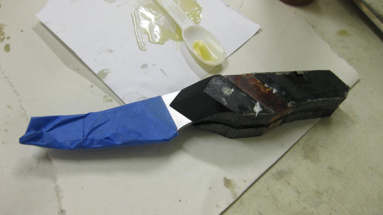

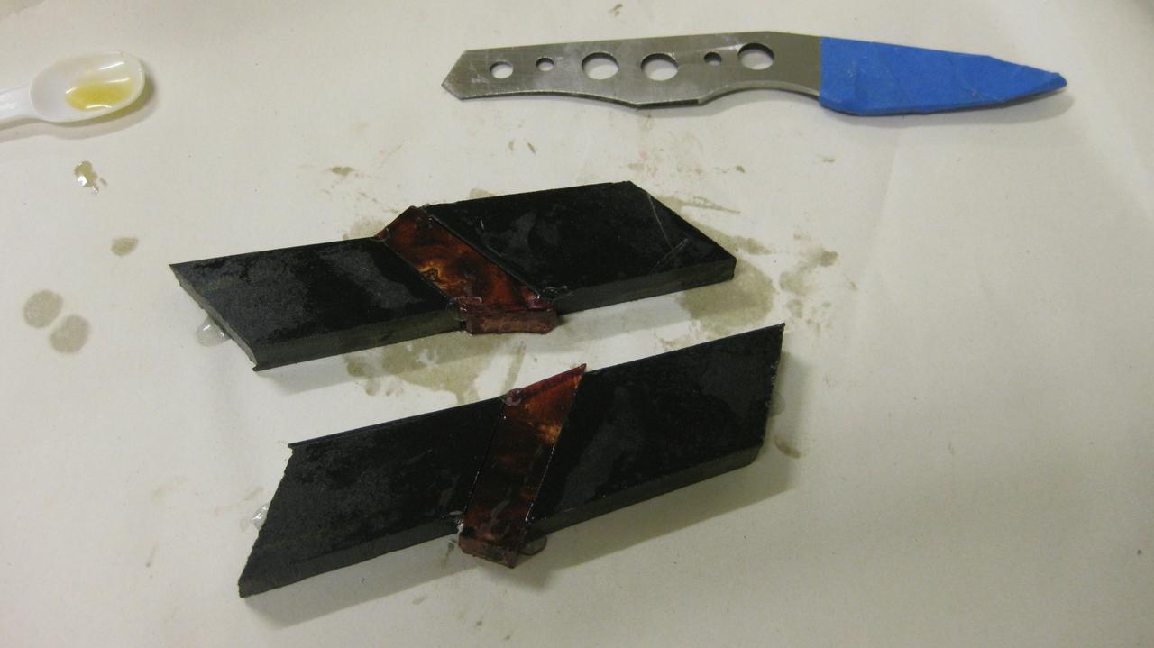

An update on the little edc - the handles are drilled and fronts shaped+cleaned. It's getting glued right now. You can see the glue but I'm about to wipe that again in 10 minutes.
Also, like my other knives, only one pin is visible. The other is hidden.

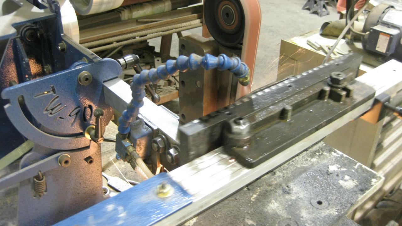

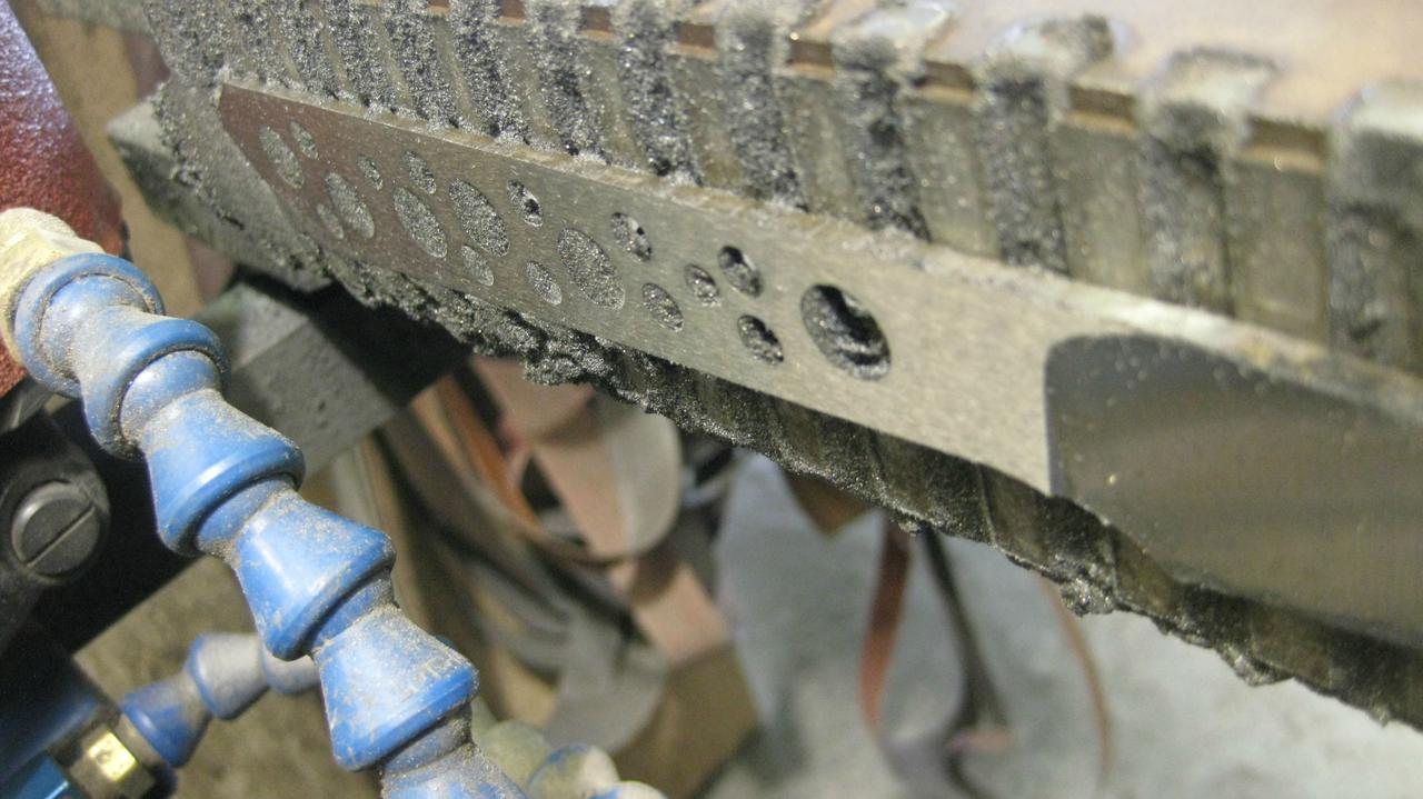

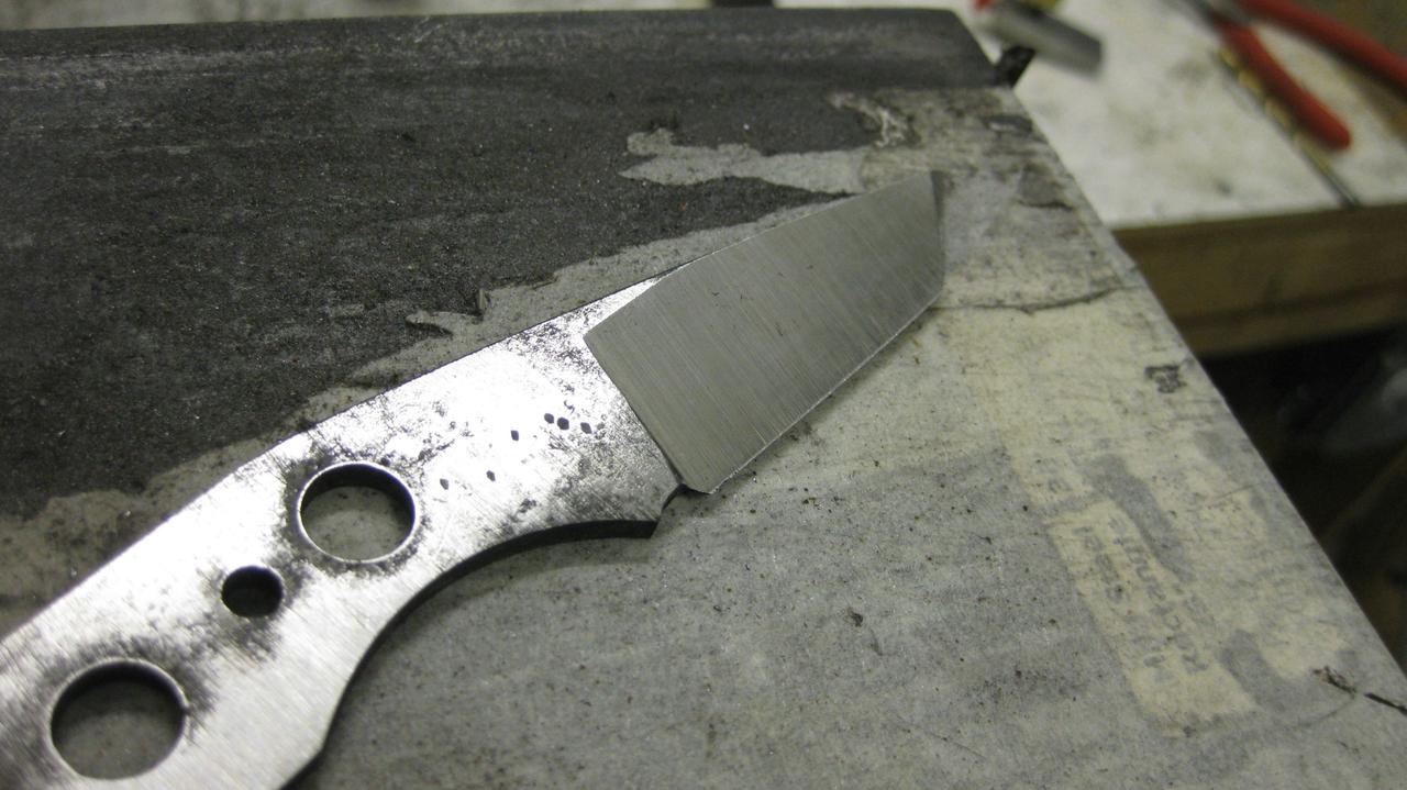

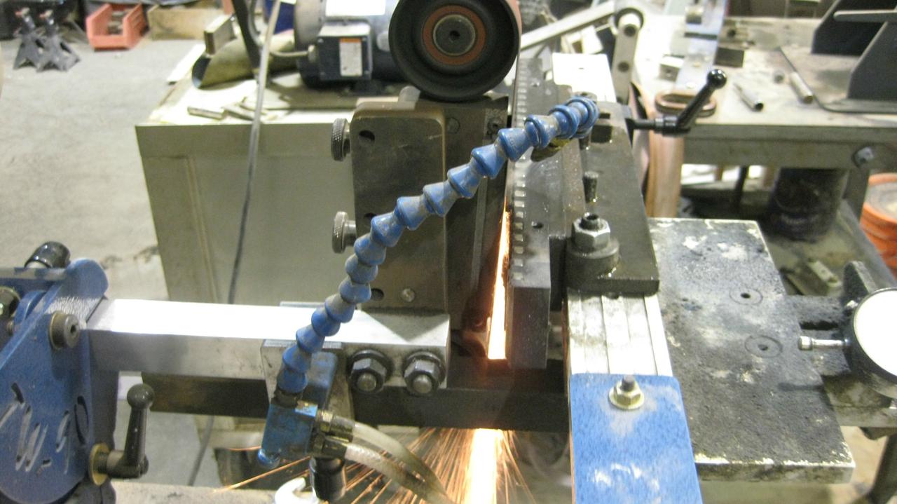

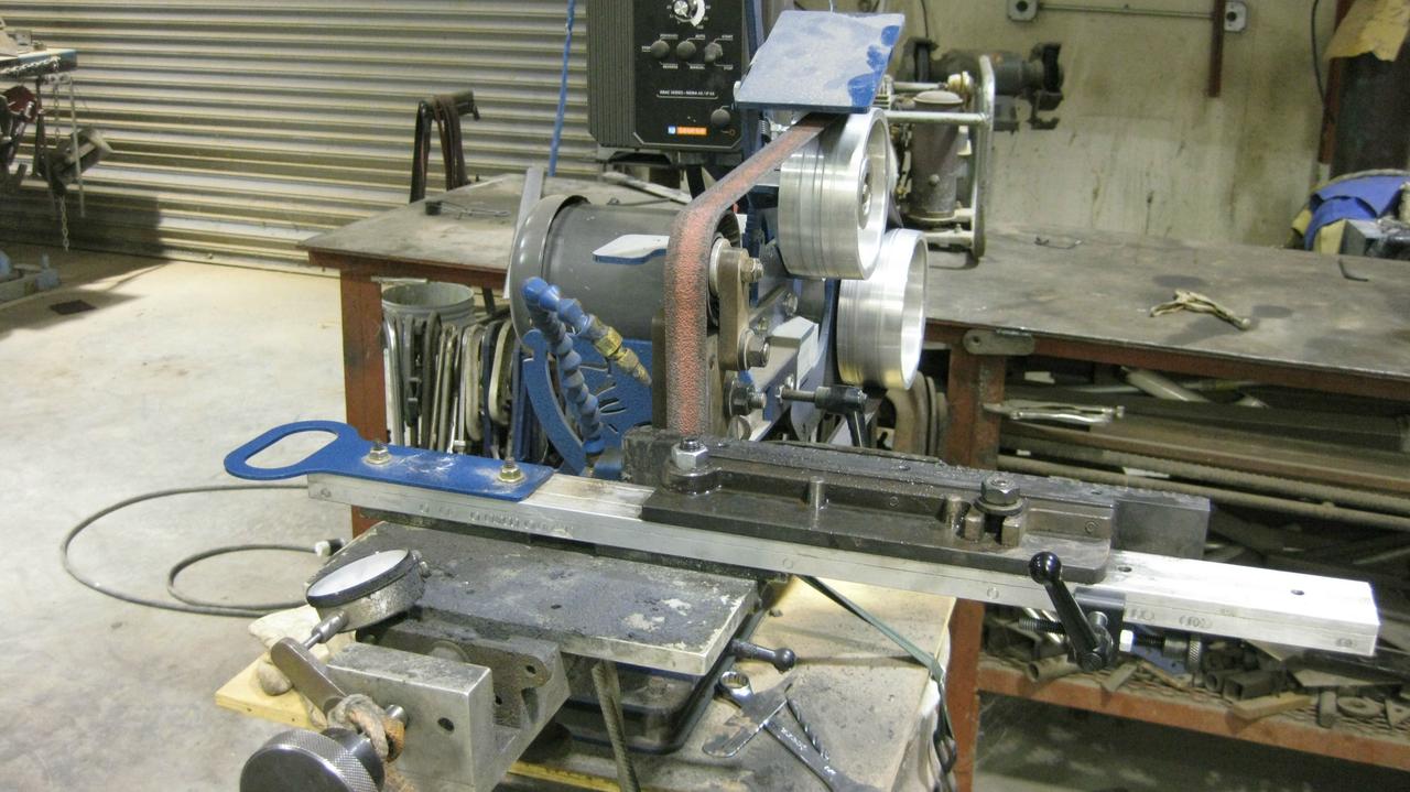

Today, from the gracious offer of a good friend of mine whom many of you know, I got most of the blade work done on the parers. At home these would have taken me a long time, but thanks to the sophisticated equipment, I can cut down the time immensely on batches. The result is the same knife, just faster :) I like fast.

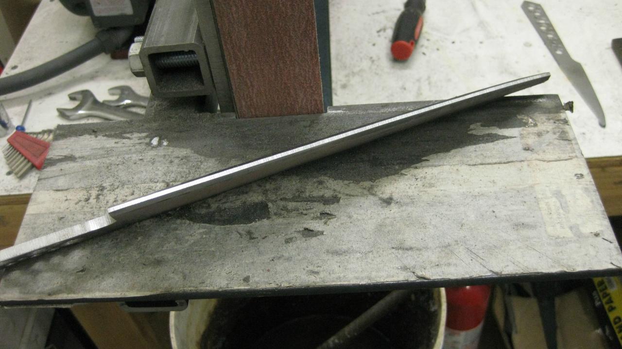

This one is a little experiment on a 4 minute total grind. The whole blade is ground to a bevel, tang included. Makes a really light knife in no time at all. It's not something I see myself doing, but it's pretty awesome.
1" platen with carbide surfaces, for grinding bevels with plunges.
The plunges come out consistent, but not at an angle I like looking at. Quick touchups by hand change that easily.
Tapered tangs. I like this process a lot. I might just get spoiled :o
EHHHHhhhh? I'm not entirely sure I like the handle geometry all that much. I didn't really plan it out, so that was my fault; this is what I get for winging it. It's not terrible, but it's not something I'd put up for sale.
Not sure why my buffing belt started to make the handle red either, but it kind of works. I've been using this belt for a while and it hasn't done that ever since I put a lot of compound on it. Either way, I hate working with micarta. I like the look but I hate, hate, hate shaping and finishing it :grumpy:
Who knows, maybe this handle will grow on it. After all, it's my personal prototype :) Better photos to come.

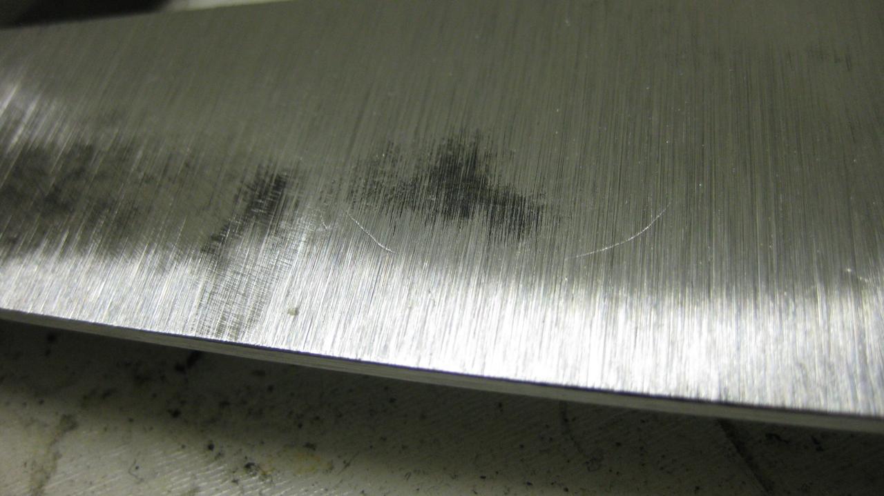

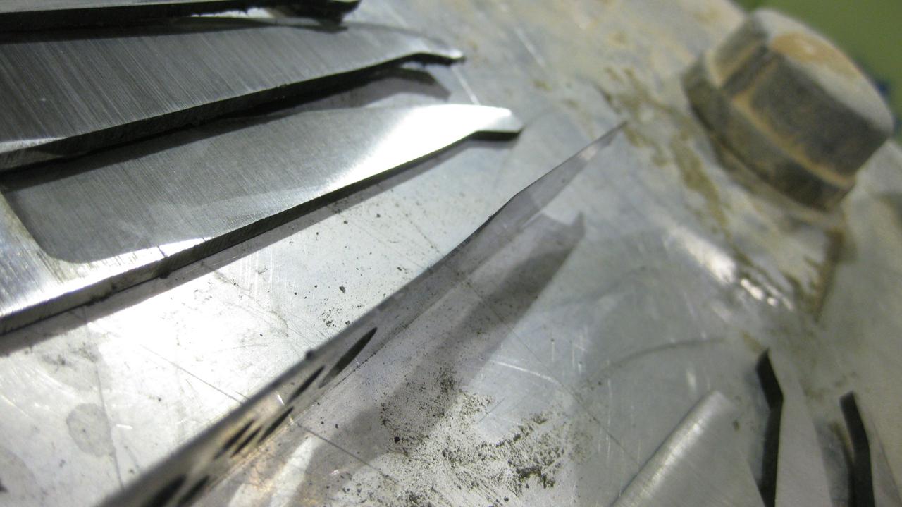

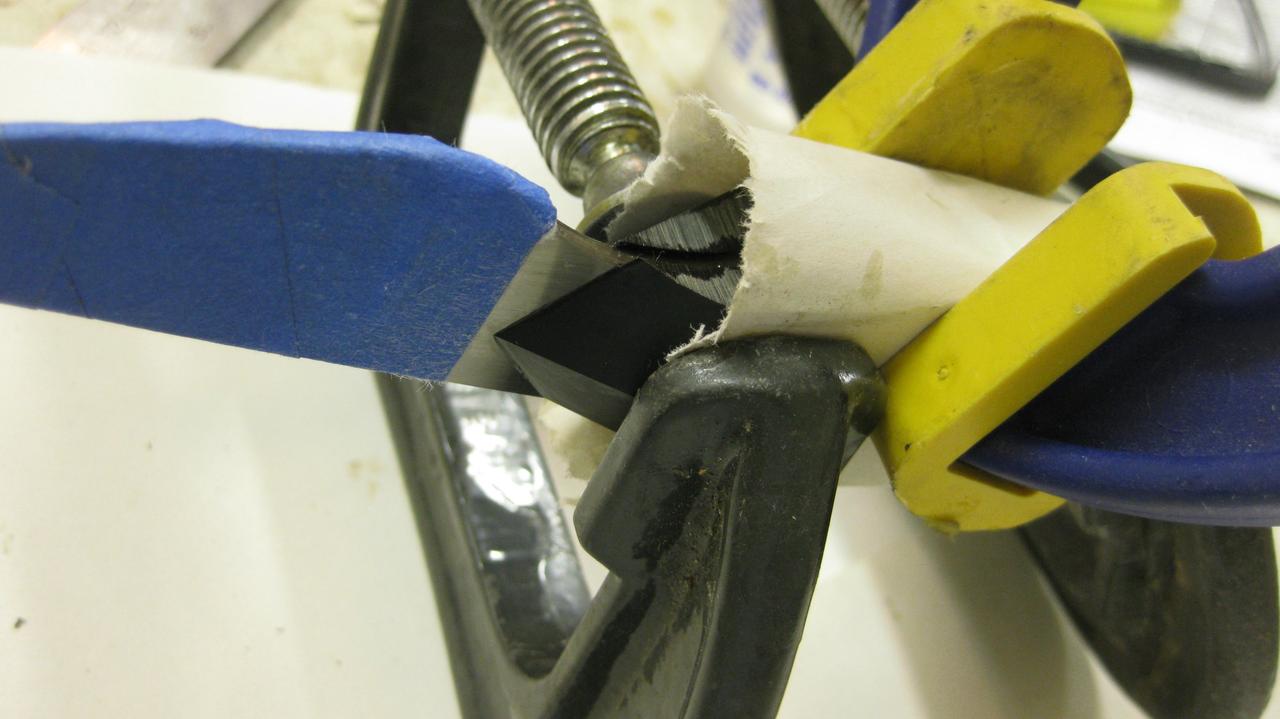

After getting the parers mostly ground, I thinned the blades next. The method seen above provides a thin geometry with a straight edge, but leaves the tip thicker and I didn't go to a complete zero edge. Here I basically do a really quick, dirty edge on all the knives. What I'm looking for is to kick up a burr without changing any of the profiles. After I get that edge, I thin everything until the edge bevels are just a faint line - that's the geometry I want. After hand sanding, these should be able to be sharpened up really easily.
In the picture you can see a really faint line along the edges, which shows how thin I'm going. For all my kitchen knives I want them this thin.
