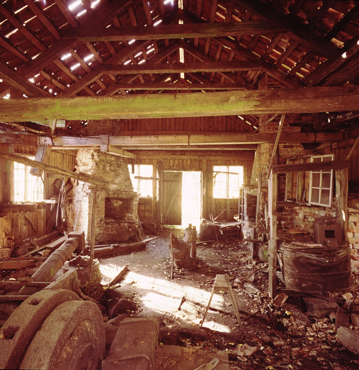

This axe is from the old Wira or Vira forge A water powered forge north of Stockholm.
We all are familiar with the video upload of the 1920s action at the forge, probably that smid in the film is Carl Frederick Dahlgren whose name is stamped on my axe here.![]()
Photographed by Westfeldt in 1920.
I like Wira because of the quality of the soft malleable iron, Lancashire iron I believe, combined with the high carbon content edge steel.

The thing I am on the look-out for is indications of this but joining of the bit which seems to occur in the old-time video.
Yes, it makes sense, the socket on that one showing distortion.The poll on CF,that extra plate,may've been added later by someone...
such a but joint strikes me as less common than many of the other options for adding on the bit
Could you be more explicit please, leaving as much of the jargon aside for my sake.he forges it clear over the bit on each side
It has me wondering myself what the situation on both the axes is with those worn back toes. All the more reason to understand the bit so that when I take it to the smid for re-steeling and who knows even re-polling, I can explain.that chunk of steel he uses in the video is admittedly small,kinda on a stingy side
