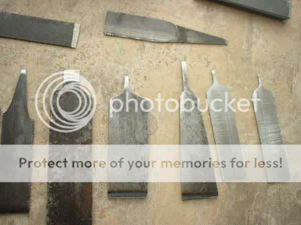

I would like to try inlaying wire on some of my knife handles. What type of tools ie; chisels, mallets, scribes should i use?

The tools are tiny chisel/knife blade tools ( they look like mini chip carving tools) with a "tip" about 2-3mm wide and a length of about 3mm. You make them from old hacksaw blades.Joe Keesler sells a kit with tools,wire,and instructions.The tools are pushed into the wood to separate the grain and make a slit that the wire (actually a flat ribbon ) is tapped into. IIRC,Bill Moran covered making the tools and doing the inlay in his "Handles" video pretty well.

gpong to inlay a wooden sheath with copper wire. been practising with various tools but these pics combined with the tutorial in another thread should make sure it comes out ok.
