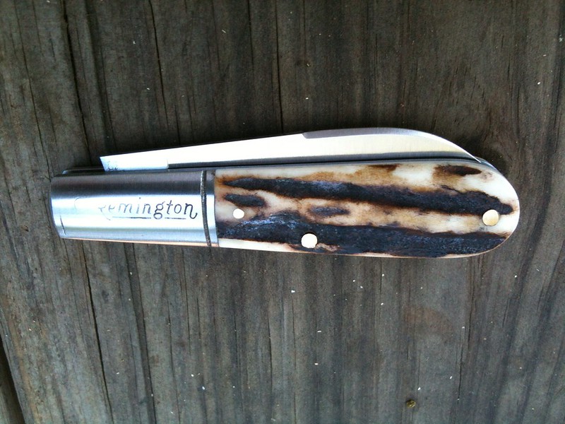

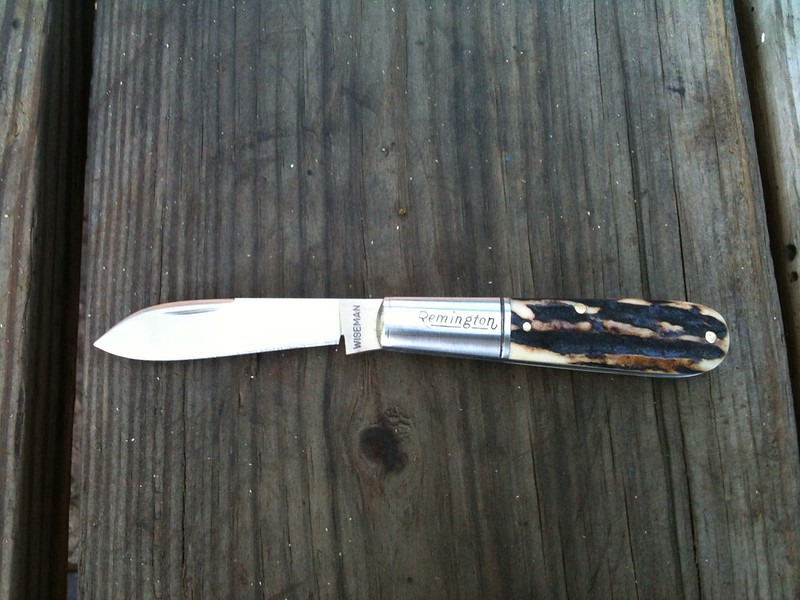

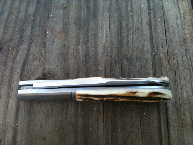

I bought an old broken Remington Barlow on ebay and used the pattern and bolsters to build me a new Sunday go to meeting knife. I just had to guess on the blade shape so I made a spear point much like a boy scout knife. I mill relieved the liners and used D-2 for the blade and spring. I used stag just to fancy it up a little.
Thanks for looking,
Gene
