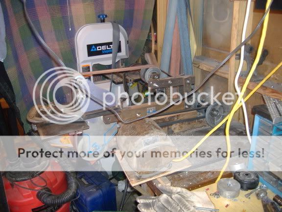

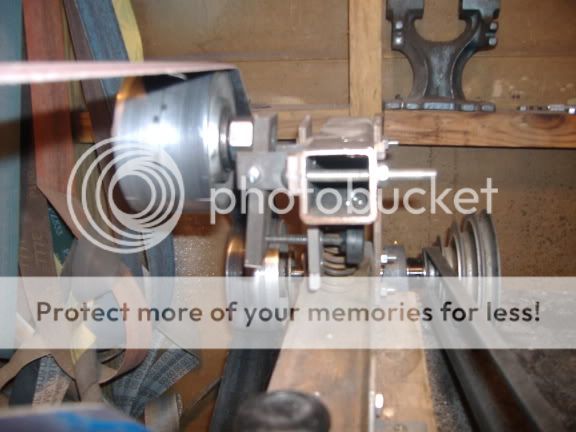

thought I'd second the thought on building your own grinder. If you have the mechanical ability or even if you think you don't give it a try anyway. I feel pretty proud to when using my grinder knowing that I designed and built it. Not that I can take all the credit for it's design I was definetly influenced by the KMG but I have spent less than 50 dollars in building mine and 30 of that was for pillow block bearings. Alot of it was scrounged up supplies but even if I bought everthing it would be less than $150 I'm sure. The point is give it a try, just don't spend as much as buying a KMG doing it. Here are some latest pics of my grinder.
Sometimes HMG's work wonderfully for many years. The best ones seem to be based on a commercial design. What I have only rarely seen is someone coming back and admitting it if their design fails after a year or so because of cheap components. ;)
There was a young man on another forum who built himself a grinder out of 2x4's and casters for wheels. he really bragged it up, and ignored warnings. He ground himself a couple of simple knives and then started chiding people who had spent the bucks for a commercial grinder, laughing at them that his cheapo was as good as theirs. Not too many months after that he actually had the admirable guts to admit his foolishness, as his grinder had self-destructed. The casters had not held up to the high speed and the construction just wasn't rigid enough. He learned why good components cost more, and that there's no such thing as that free lunch. He got discouraged, didn't have the money for a store-bought grinder, and quit.
I only have two points, here: I agree that there is nothing wrong with a HMG if built well. The second point is there are certain components that should be industrial quality. A contact wheel made out of parts from a Radio Flyer isn't going to be as good as my CRC wheel, no matter what you do. Get good bearings and pay attention to rigid construction....
