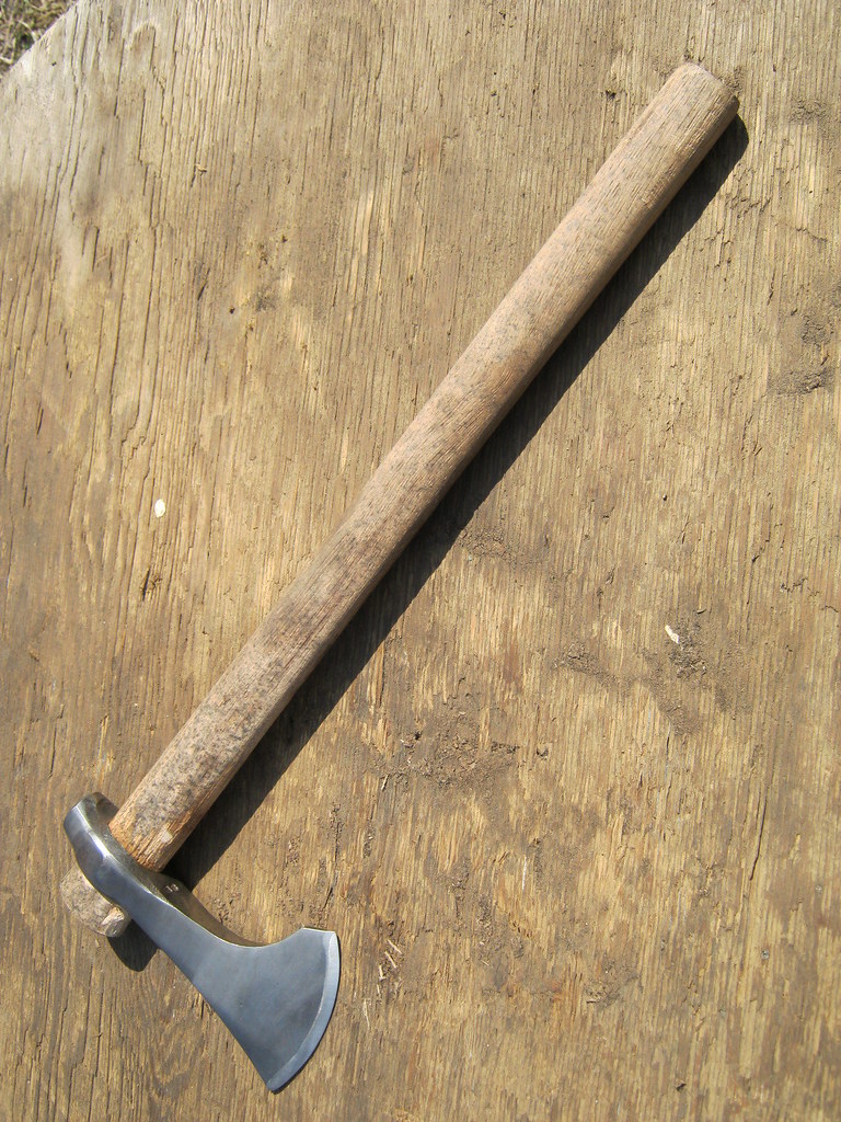

You might want to talk to the blacksmith called "Kentucky".
...the hammer poll was also heat treated like a regular hammer..
4 5/8" wide bearded cutting edge. Hair poppin sharp..

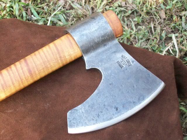

Kentucky AKA Wolf Creek Forge make's some nice Hawk's, Here's another one that he made and I'm sure If you wanted one like this made with a Hammer Poll he would do It,
That's what I want, a bearded axe with a hammer! Been looking at the 2 above for quite some time.
Going to have to start saving up. I gots a feeling they aren't cheap!

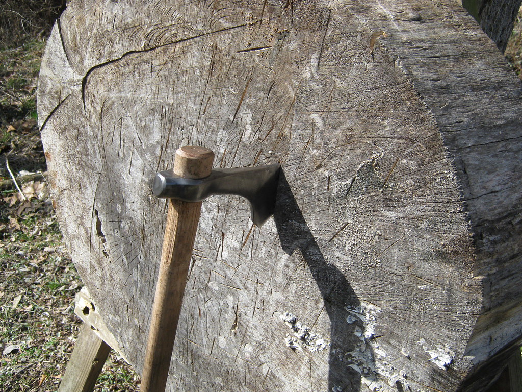

Seems a bit large for a pack ax, but that may just be me. I know that this one I made easily takes down 6" mountain cedar:
It's 3 3/8" from the top of the blade to the bottom of the beard in a straight line. Very light, very capable.
But a 5" blade would definitely be do-able. :)
I think you guys are right, 5 inches will probably be larger than what I really want,
From some stuff that I have handled the last few days, I am thinking a 4 inch or so cutting surface would be good.
