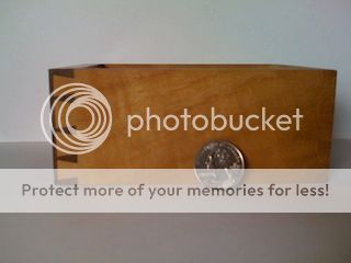

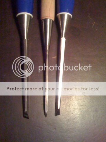

Here are some little tiny chisels I custom ground for paring and fitting very small dove tails like in this drawer.

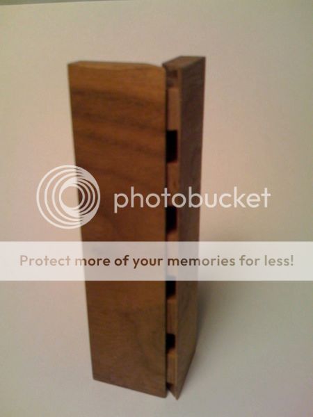

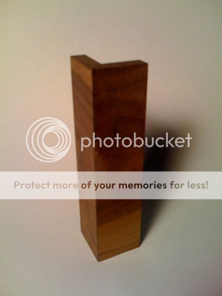

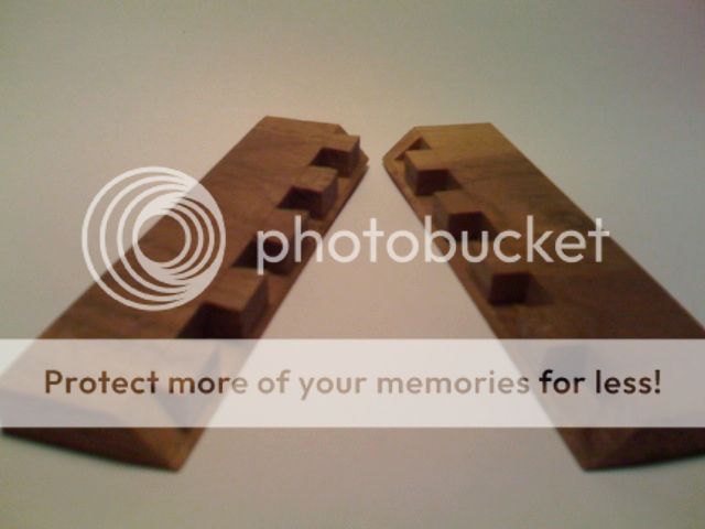

Just a little more. This is a joinery sample I like to show to people. Picture it as the corner of a drawer or two cabinet sides.
It is called “Full Blind Dovetail Joint” When it is put together all the joinery disappears and it looks like a simple miter sawed joint. Inside though it is super strong and designed to last hundreds of years. The glue tends to breakdown over time but if this joint fits right and is used right it can basically still be quite strong and useful with little or no glue. It can be pined to lock it from coming apart.
Just requires a fine saw, some precision layout tools and the paring chisels shown and a dovetail chisel. NO POWER TOOLS AT ALL.
For perspective these pieces are about five inches long and about a quarter inch thick (6mm) but this style joint was often used in massive nine foot tall furniture (ceilings were higher back in the day).
