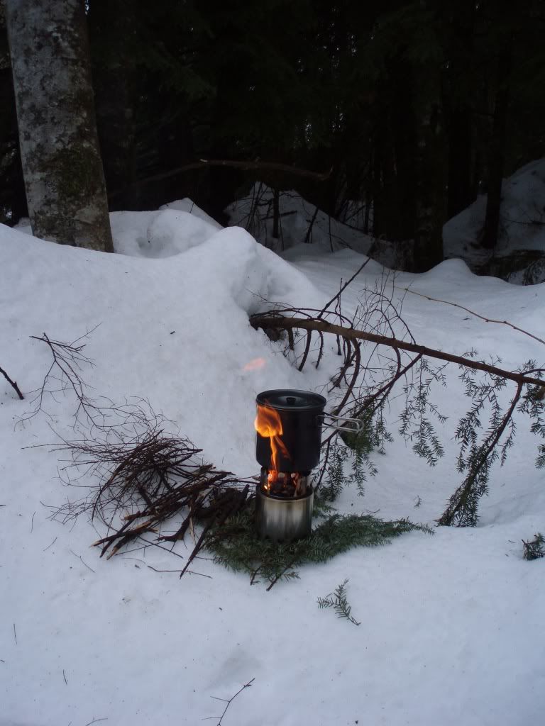

this is the wood gas stove i made earlier this year
using instructions from bushcraft usa
http://www.bushcraftusa.com/forum/showthread.php?t=6270
this pic was its first outing and it worked well, got the gas going readily. since there was fresh fallen snow, i found dry sticks from broken limbs hanging in trees.
found that i had my pot sitting way too high so altered it

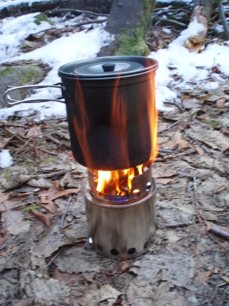

[/IMG]
the result being quicker boil time and less fuel used
since then i have altered once more(sorry no pix right now-but will next time its in use)
removing the screen bit and replacing with two strips of steel notched to use as an X and sits down over the lip of can. this seems much more stable to me and allows me to add fuel on any side. i have used this stove many times now and found it quite efficient. and as long as there is fallen wood in yr area, fuel is a simple matter. also use a trangia stove and like it too. they are different beasts. end results the same.
