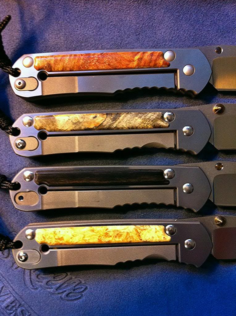

Quick and crappy iPhone pic;
These are LE Wood Inlays so the frame is the regular style, as you can tell. Top to bottom is 1999 through 2002.
The first year they did polish the lock bar, but that year only on my examples. I must have dropped the ball in '01 as the knife is lacking the insert as well as double thumb lugs (my standard order when I was buying the LE's).
In '02 they started to polish the clip insert as well, if you ordered it with the knife, and you will note that the '02 is missing the telltale marks on the lock bar where the clip normally touches. They changed the relief on the lock bar that year as well, instead of the large shallow cutout it is a few small grooves further from the locating hole.
