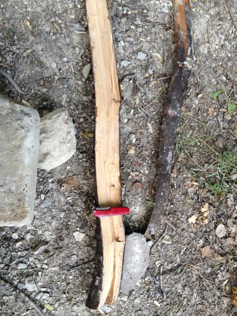

First I split a branch using the rocks you can see sitting around it, that was the first time i'd split wood using only naturally available materials..

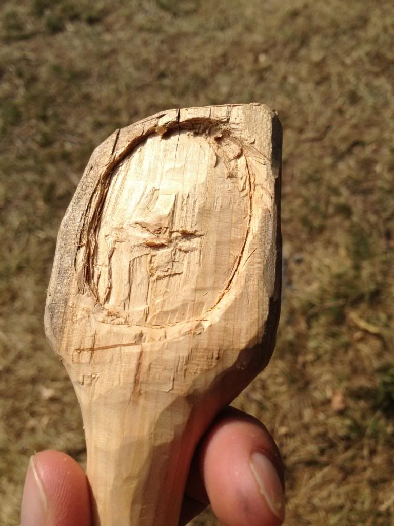

Then I just rough carved out the shape of my spoon.

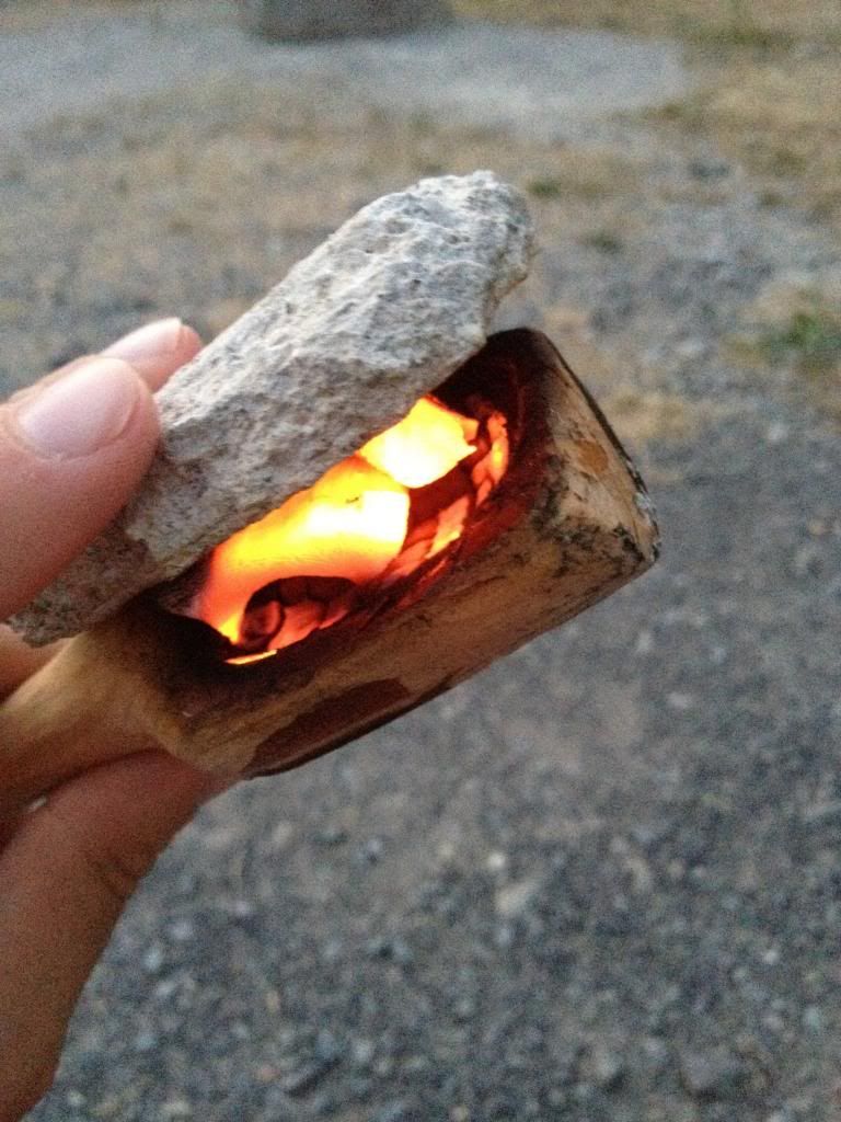

I made myself a little space to sit my coal in so that it wouldn't slide around all over the place.
Then, once you've established where you want the bowl to be, start burnin!
You take a nice red hot coal from a fire, simply place it on top of where you want to burn out your hole and gently start blowing on the coal.
and just keep going until its your desired depth
foolishly, I never took a picture of the finished spoon lol but it looks like the second picture with a deeper hole and more finished handle
